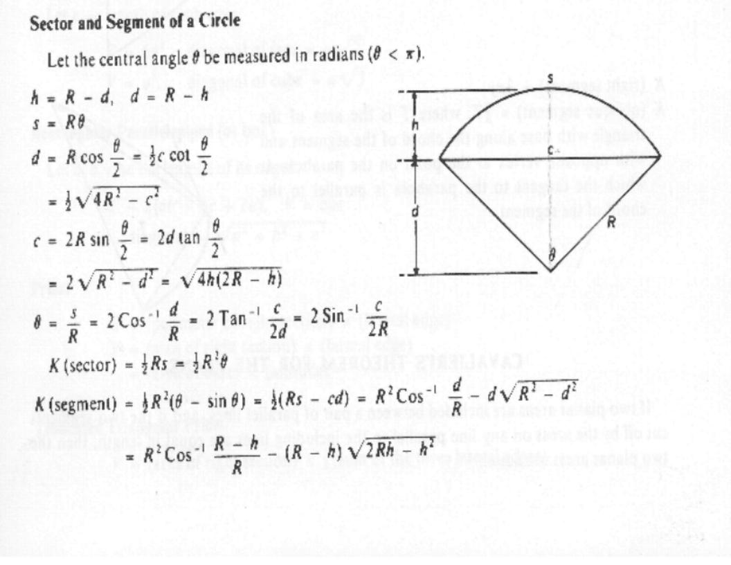

Gary:
Here is the scan that I mentioned in my PM to you.
A "cord" is the line marked as "c" in this diagram. The arc "s" represents the tank wall. Hope this helps and is not too confusing.
Regards,
Darwin
