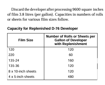

What is the capacity of replenished D76, I use old stock off the shelf Acufine Replenisher, the directions on the label on the can states that a quart of replenished Acufine is good for 64 rolls of 35mm X 36 exp. or 120 film, and by extrapolation 128 sheets of 4X5. Will a quart of D76 replenished develop 32 roll of 35mm?

When it comes to replenishment, the differences between the more modern X-Tol and the historically prevalent D-76/ID-11 include the fact that X-Tol was designed to potentially never require that the working strength solution be discarded, while for D-76, the following applies:

The folks I knew who were members of the D76R cult kept there tanks going for years at time, some replaced half of the working tank with fresh D76 every 6 months, while claim to never discard working D76R. Life of tank should be how long?
