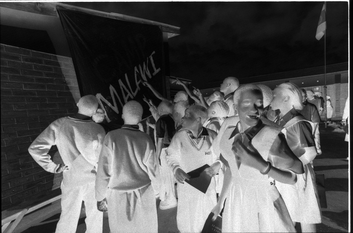

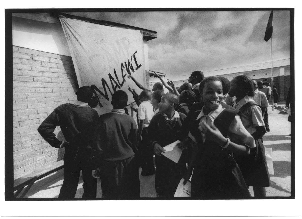

Attached are the negative scan and print scan. You can't see anything in the negative scan--only when holding the neg up to light. No matter that I now realize I can get a somewhat better scan out of it, I still need to know how to make a print of it, if possible.
So yesterday, I hadn't seen the responses yet because I go to the darkroom quite early. I decided to go ahead with the split-grade, masking each part separately. Overall result is too dark and grey, although more subtle than the scan in a way. I just couldn't get the contrast to my satisfaction without bringing down the sign color and then wanting to bring down the rest of the print to match. I guess it was a lot of effort just to get to this point--2 full sheets of test strips, one sheet just to check exposure across the whole frame and then to cut into masks. Three sheets before even doing the final print... 5x7 RC sheets, but still! What are the other techniques other than filtering/masking? If we pretended I had extraordinarily steady hands, could I paint something on the "camp" on the negative that would darken it?

There is a limit to how much contrast can be applied to the flag unless I'm just doing it wrong. The word is so light that at grade 5 it blows out with the rest of the white background. I might give it another try next weekend but for now I think I'll have to skip this one.
