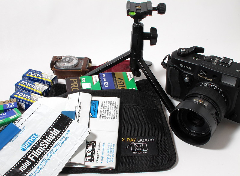

When I travel on holiday as a tourist and plan on shooting a lot of scenic shots (such as landscapes, cityscapes, skylines, sunsets, sunrises, moonscapes, seascapes, lakescapes, and beachscapes), I like to carry enough 120 medium format roll film to shoot at least two-dozen photos per day because that is the average I normally shoot.
Travel Camera by Narsuitus, on Flickr
