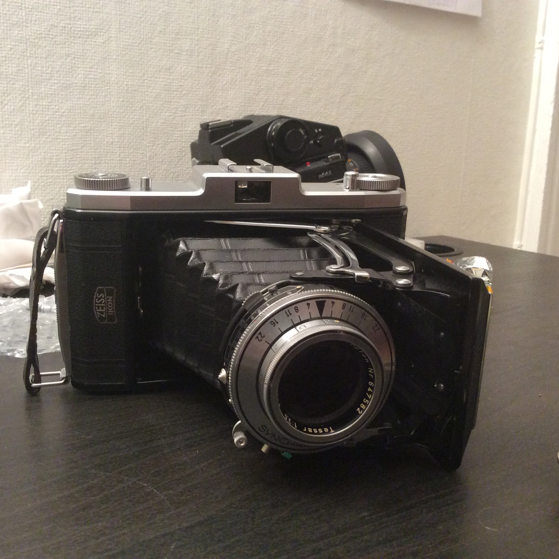

so I just got this camera and the film winds right to left, so I loaded up a roll of portrait 160 upside down but now I can't see any numbers in the red window. Does anyone have one of these? How many rotations per frame? Wondering if my shutter release lock/winder is accurate?

I can't tell from the picture which Zeiss folder you have, but I have a 6x9 Zeiss Mess Ikonta which feeds right to left and I have no issue with seeing the frame numbers in the red window. Do you know which model you have? A Google search perhaps...

I believe it's a
Ikonta C 523/2
Red Window on bottom right corner

Use a flashlight to check - the new film numbers on Kodak 120 are a lot fainter than the old ones used to be.
There has been a serious problem with the new ink used by the backing paper supplier interacting with emulsions.

Also, if you end up having to rely on the number of turns of the winder, the number will vary over the length of the film. One turn at the beginning of the film will move the film less than one turn near the end.

Look at the numbers in the red window because the number of turns changes through the roll.

Assuming you have a 6x9 camera, and a 120 take-up spool, 2-1/4 turns at the beginning of THE FILM (not the paper) and slightly less than 2 at roll's end should give you at least 7 shots per roll. Put the break point after exposure #4 to begin, experimentation will tell where is best. Draw a line with a marker from the center to the edge of the wind knob for your reference, of course.

The way roll film is wound on to the spool assumes the film is fed from left-->right (looking at the camera from the back.) This way, when you set the film emulsion down--after development--all markings on the film edge read properly. My Zeiss 6x9 folder, and it sounds like on crumpet8's folder, too, a new roll of film is loaded on the right side and winds to the left. That is, right-->left; ergo, upside-down. It really is a bit disconcerting when you put the negs on a lightbox for review. I normally have to turn 'em a couple of times before I get the orientation correct! :smile:

You could sacrifice a roll of film to advance through the camera with the back open, counting the number of turns needed between frames to prevent over-lapping and minimize film waste.

Or you could take the left over paper from a developed roll and approximate the same thing.

Thanks for the input everyone :smile: shot some new portra 160 and had numbers, but still having a small mechanical issue with the winding not releasing the shutter mechanism to be able to fire sometimes. Good news is I can bypass that.
darinwc, I meant I was holding the film to be loaded from left to right and then rotated the film 180 degrees so it would load right to left.

Due to all the fooling around I only got about 6 shots from that roll, many of which became double exposures, but it suited my project fine so was happy.
