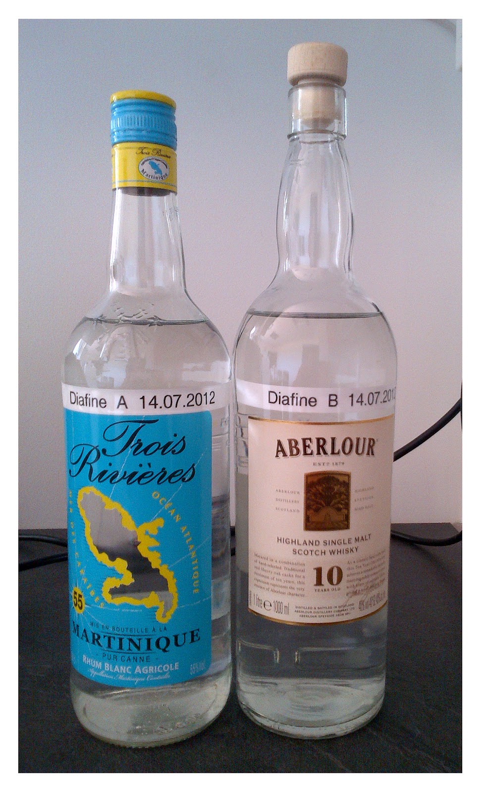

I will have to call the shop who sold it to me to see if they have still some on stock. In fact, from now, i just make a small filtration, but no replenishment. Because i didn't have anything else to store, i made one quart of A & B and stored them in 1 liter bottle. Is it dangerous for the product (a bit of air remaining, see picture below)?
What i understood from you is that diafine doesn't have to be in contact with air because of oxydation. Do you think i have to look for another storage system.
After 6 x tri-x 135, 1 x fp+ 120, 2 x fp+ 135, Tank A begins to turn purple. Nothing in tank B except a "black" sedimentation.

Hi Rom,
Your storage bottles are OK. I would keep them in a cupboard or other location where they're not exposed to direct light.
The solutions will not oxidize. The only reason for filling the bottle for Solution A is so you can measure the amount of
fresh solution that you add during replenishment. If you're not replenishing then it doesn't matter.
The volume of Solution A decreases with use because it's absorbed into the dry emulsion, and carried into Solution B.
You can certainly use it without replenishment until the volume of Solution A falls below the amount required by your tank.
I would suggest getting additional storage bottles and going to a replenishment system when circumstances permit.
Discoloration of Solution A (and sometimes of Solution B) is normal, as mentioned previously, and is of no concern.
