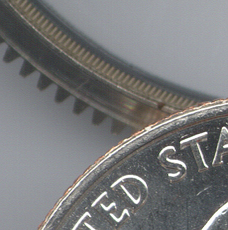

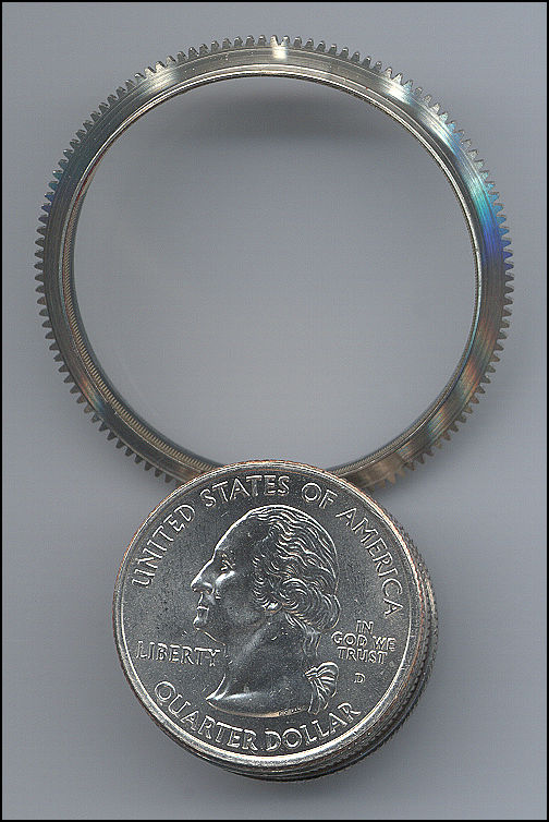

Are your lenses non-AI, or are they AI/AIS? If the latter, you could probably go for a DP-11 prism, instead of the earlier DP-1. In either case, try to get a prism that has a red dot on the underside of the shutter speed dial stack. Those are the prisms that have the wire-cladded ring resistor.-J
That's an interesting bit of info, and one I had not heard before. What exactly does the "wire-cladded" modification refer to?
The images below show the original ring resistor from the DP-1 meter of an early (c. 1974) F2 of mine. It was removed and replaced by a brand new ring a few years ago as part of the camera's first-ever maintenance. I know this because I'm the original (and only) owner. The shutter speed dial stack for this meter shows a red dot on the underside.
