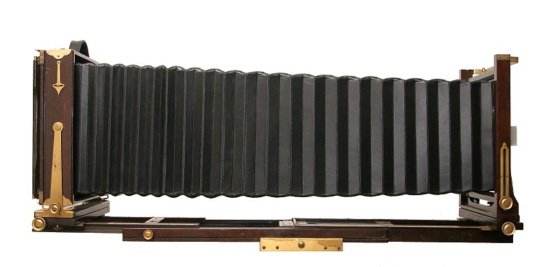

I am in the early stages of building/designing a 11x14 flat bed. I have some specs from the builders on-line, but in the real world, how long are you guys really stretching out.
I'm a stick and stone landscape guy. Don't think I'd ever want to chase bugs or flowers up close. I don't have any lens yet, but in my 4x5 I have a 90, 150, and a 210, and I feel pretty happy with them, and don't feel the need for more. Most of the time its either the 150 or the 210 so I guess I'm usually pretty close to normal.
So, what do you guys think? Is 3 feet going to be enough.

If you plan on ever selling it, then I'd say most 11x14 users are going to expect a meter or more of bellows on that size camera.

For 1:1 macro images (with non-tele lenses) you need bellows length twice the focal length. That is a pretty good estimate of maximum bellows length you'll need (although I think there is a lot of good work to be done in LF/ULF beyond 1:1 and we shouldn't automatically cede that territory to smaller formats).
So, thinking out loud. With a 480mm I'm good for 1:1 with 40 inches. With a 600mm I'd need closer to 4 ft for 1:1.
40 Inches is starting to sound about right.

Tim, I've done quite fine with 36" of bellows. Remember the lens coverage increases as you get closer and extend your bellows. I've done some nice 1:1 with my 12" Gerogon.

The bellows extension has less to do with the lens choice and is more to do with the actual design of the camera. You need to decide whether the camera is to be double or triple extension, that's compared to a standard lens for the format. Double extension allows 1:1 focus with a standard lens.
Typically a 10x8 camera with a 300mm/12" lens has an extension of approx 24"-27" and a triple extension version around 36". Scale that up for your 14x11 camera and 36" may well be practical without the hassle of adding an additional extension rail.

When you contemplate how long your bellows should be on your 11x14 please consider how heavy your longest lens would be at this focal length and make sure that you design your support members to handle and "balance" this weight properly. This includes materials deflection properties and insuring that your tripod screw is sufficiently sturdy. A bit of research as to the range of weight of the optics that you could utilize would be well advised. The numbers could surprise you.
Personally I would make sure that my rail proportions for the front standard were at least as stout as the Deardorff V11. If you need some dimensions for the V11 I would be more than willing to provide you with some data.

The Deardorff V11 front rails are 1 9/16" wide and have a metal side plate affixed to it that has the drive gears along the bottom of the wooden rail for forward and rearward motion. This metal plate has flush mount screw driven into the side plate and adds structural stability to the rail. This front rail is 3/4" thick. The real rails are the same proportions. Let me know if you needs pics or have other questions. I use a 35" Red Dot in Ilex #5 with the V11 and it handles it with ease.

Makes sense to use an extension rail. The issue then is making bellows that don't sag, and 2 or 3 ring tabs can help enormously.
I'm about to make a set of large bellows for a De Vere Monorail and looked how the originals were made, as well as those on my two Agfa Ansco 10x8's as all have very minimal sag. While the stiffeners on the original De Vere bellows are quite thin it uses three cloth layers this seems to give the additional stiffness preventing sag, the original bellows would have been made by Camera Bellows - now Custom Bellows in Birmingham, UK.
