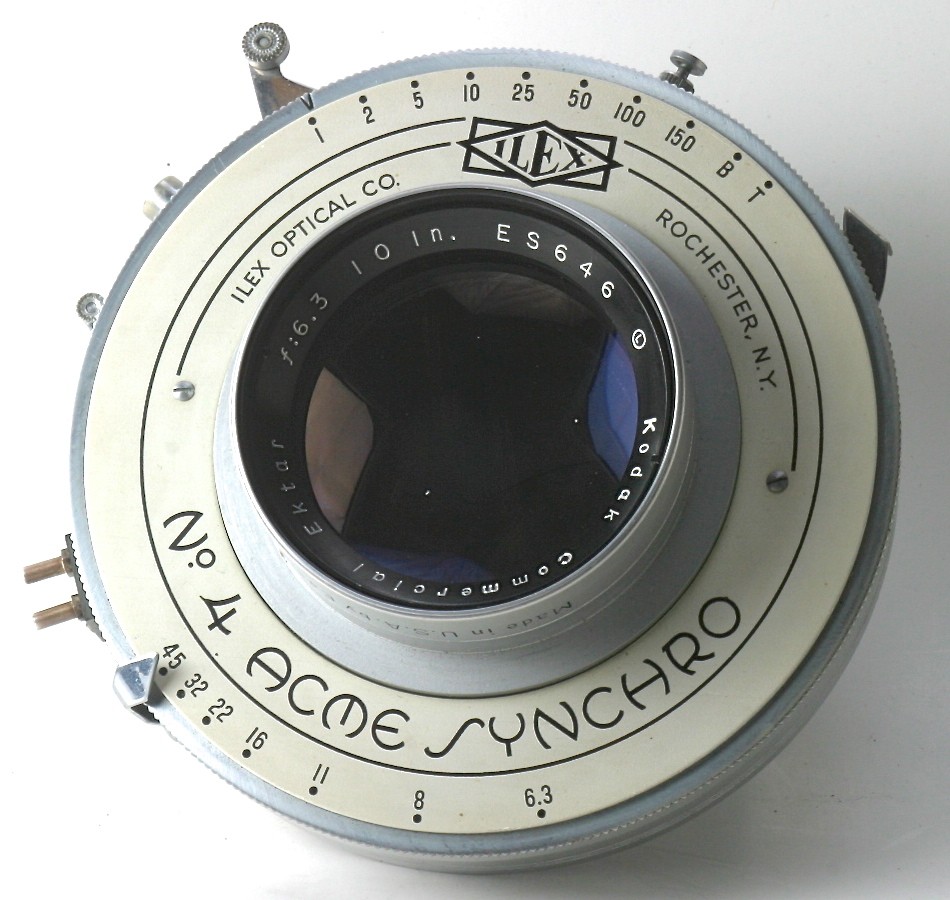

BTW: I ordered the 790mm f:5.4 meniscus lens lens from Reinhold this week. My first real ULF lens I want to use for building a large camera. My only experience up to now is only with an old Russian FKD field camera (negative size 18x24 cm, lens 300 mm). See also: http://thetoadmen.blogspot.nl/2012/09/making-dry-plate-glass-negatives-with.html
I also have a Kodak Commercial Ektar 10" (like Ansel Adams used) but I haven't used it yet since I don't have a 8x10" camera yet to put it on.
