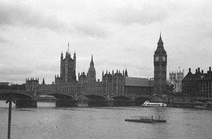

This pic is on 1967 Orwo 400 ISO film exposed at EI 50 last year and developed in Rodinal.
At 43 years old it was a bit foggy.
I have not tried any really old color film.

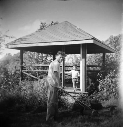

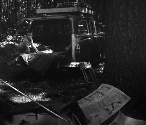

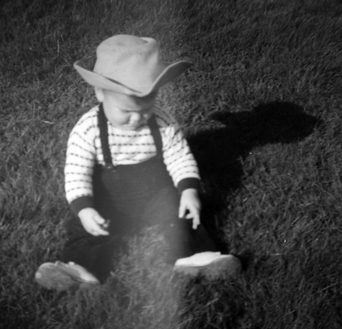

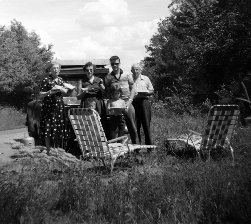

Of course! Verichrome Pan 620, expired 1959, exposed long ago (exact date unknown, wish the newspaper was in focus better), processed in HC-110 in 2011:
Fifties Dad mowing the lawn with son looking on by Harry Pulley, on Flickr
Stopping by the road by Harry Pulley, on Flickr
Old car and newspaper crop by Harry Pulley, on Flickr
Junior by Harry Pulley, on Flickr
I bought it in a lot with other 620. It seemed like a good way to get a take-up spool and thought I'd develop it, just for fun... now I wish I knew who they were! I'd send them some prints of their long lost camping trip photos.
