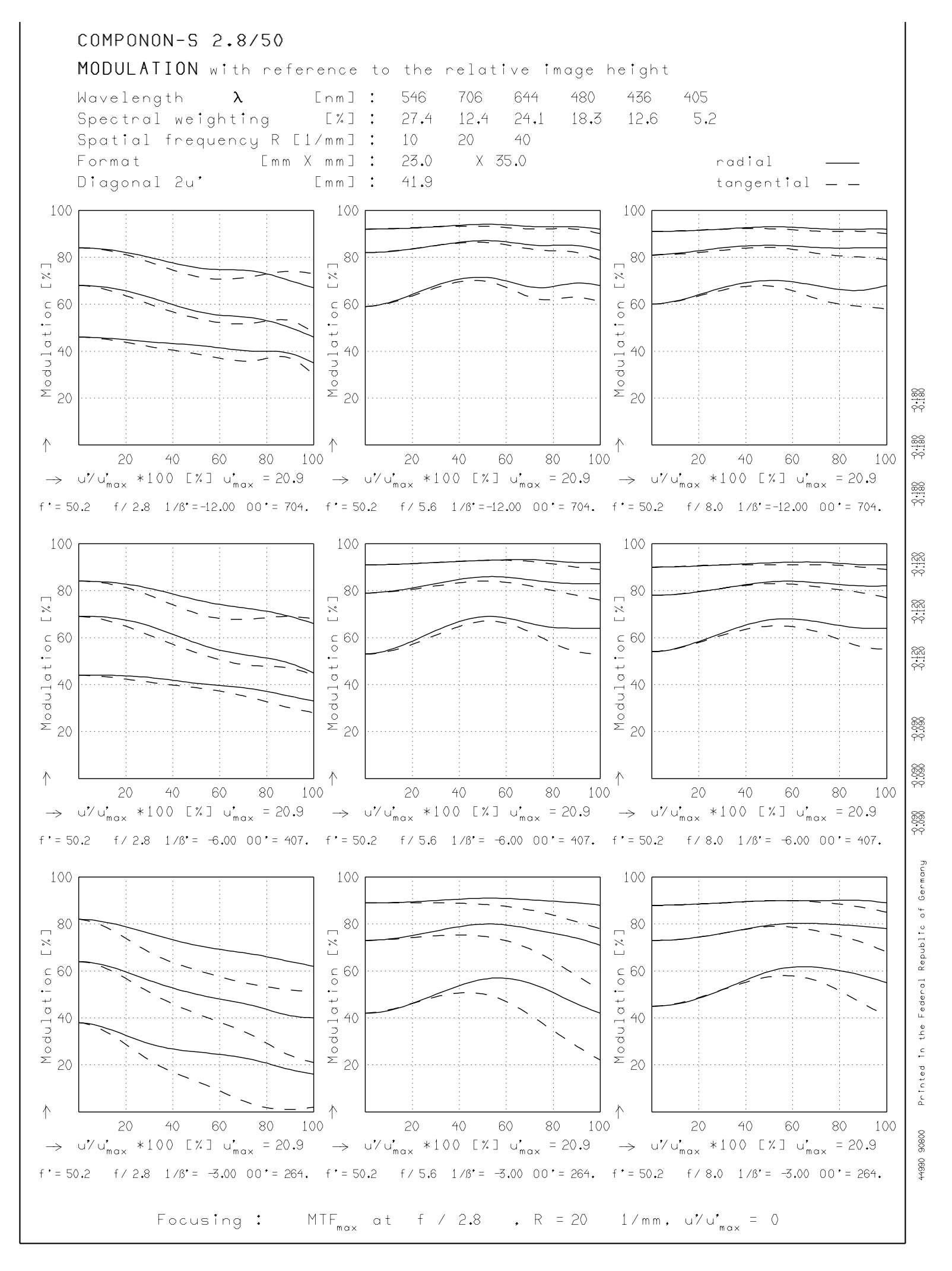

use f/11 (the highest resolution setting on my 50mm
The f11 results are not even shown by Schneider since they are degraded by diffraction. Why not use f8 or f5.6?
