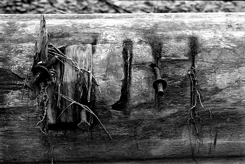

Maybe I’ll just buy a roll of 400 and be done with it. I was looking at 100 because I would like to shoot with some fine-grained 35mm for a change.
35mm T-Max 400 is wonderfully fine grained.

Thanks for the sample Matt - 400 looks good (as does your composition). Sometimes I have a hard time recognizing grain in photographs with a lot of texture. I will check out some more samples online and decide.

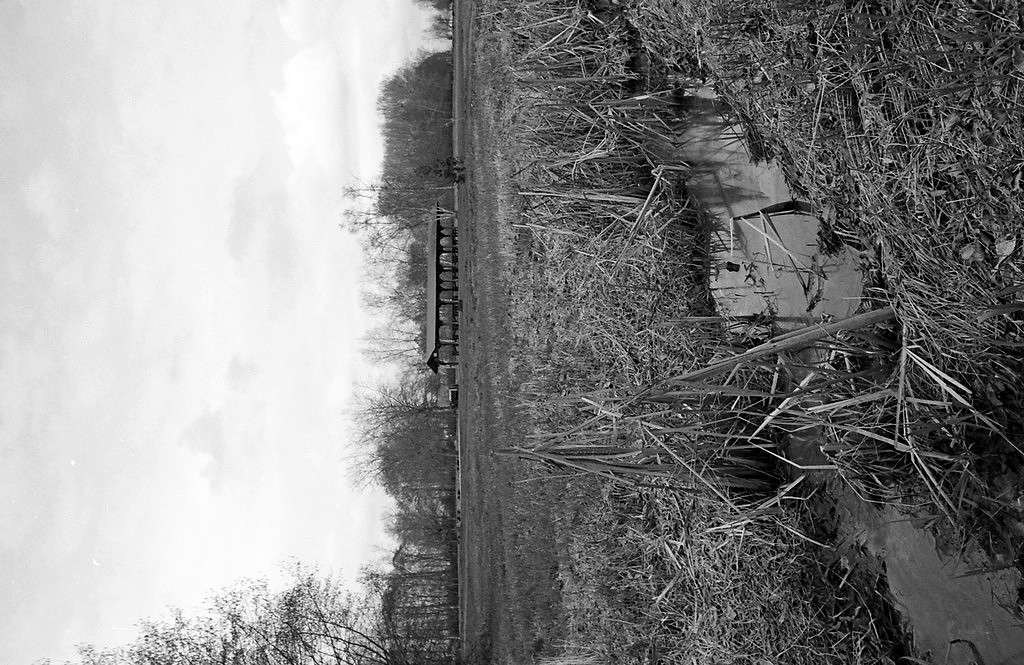

Here is another one which I grabbed from my pile of scanned but nothing done with photos.
In particular, this hasn't had anything done with it to remove dust - so consider yourself warned.
I picked it because there are areas where grain might show.
I turned it on its side to allow for a bigger image on the screen.
Who knows how well it will survive the Photrio downloader.
