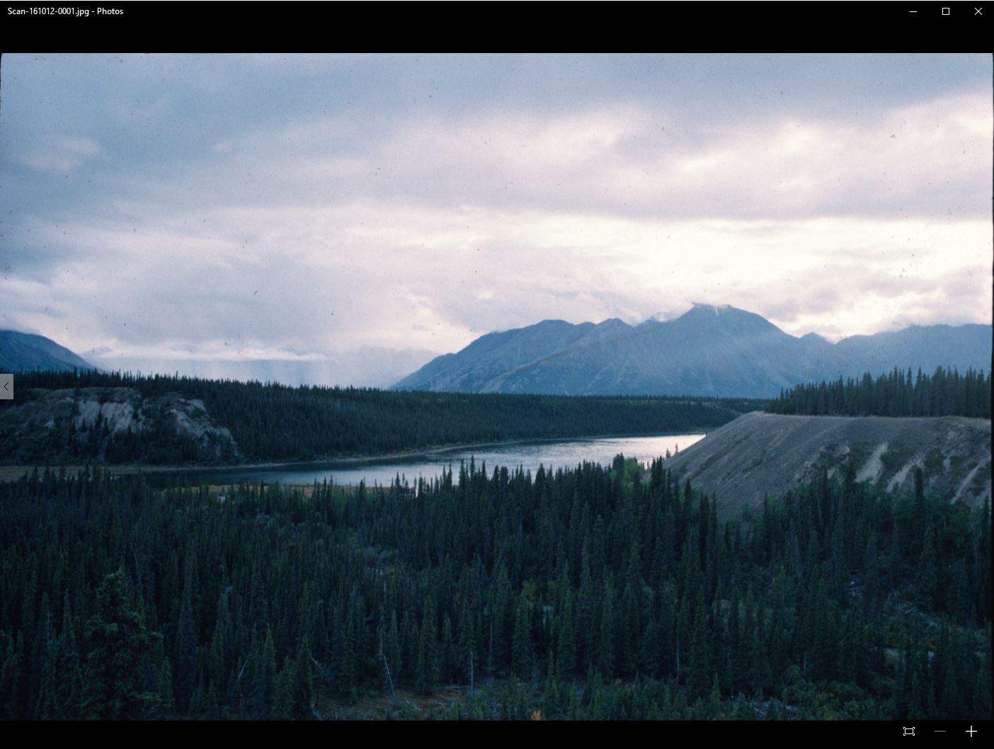

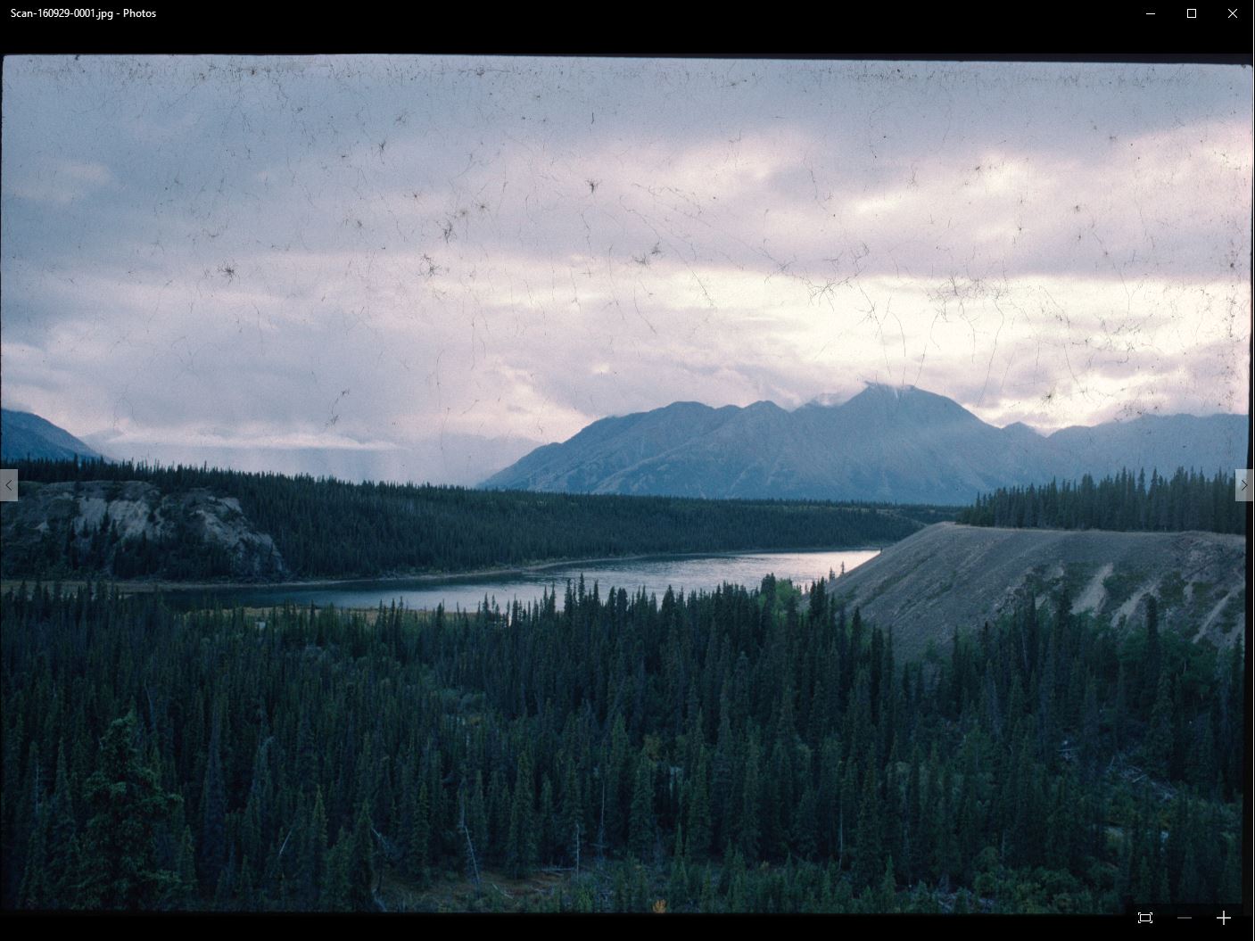

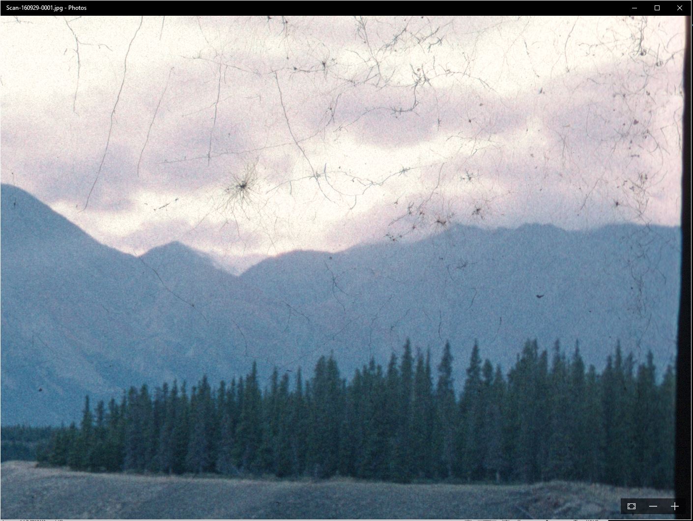

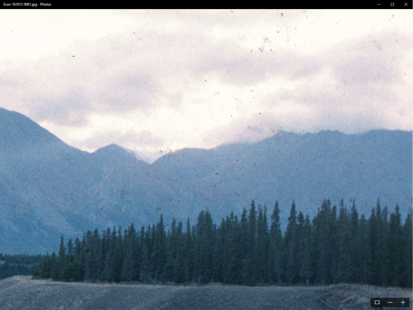

I attach images of the same slide before and after treatment. You can see that there is still some debris on the treated slide, but the task of digital retouching is vastly reduced compared with pre-treatment. Nothing else seems to be affected, and there is no sign of the emulsion being eaten away or tunnelled by the fungus. There are no scratches caused by handling, either.

Well, you can theorise all you like, but as you can see, it did work, and the film base (acetate?) and emulsion (gelatine) were fine.

OK, I did not do a control using plain tap-water; but you could do that yourself.
Sorry to sound defensive, but I'm rankled by your negativity. I really don't mind if you don't follow this procedure, though I hope someone finds the knowledge useful. This procedure restored slides sufficiently that retouching the scanned image was a viable proposition. It doesn't matter to me if the slides now disintegrate (though they may not). It's the image, not the little piece of film, that interests me. The images are now digital files, and enjoyable for a while longer. I am not trying to preserve them in the fossil record, but if I did nothing they would effectively be already lost.

Been away for a bit, so I missed these replies when first posted. Honestly, chaps, I'm not bothered; but don't you think
I am doubtful it will work.
was a teensy bit negative, especially as I posted visual evidence that the fungal threads were in fact removed.:smile:
