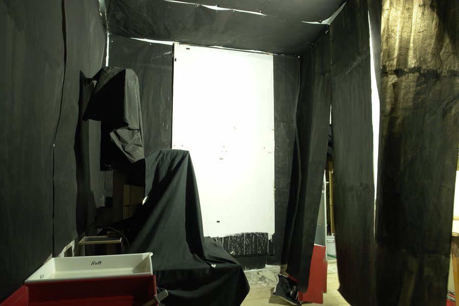

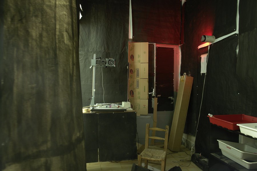

I set up my darkroom in an old house I have access to, so I had to make everything from scratch.
I used a simple Durst M60 for this job, with its head tilted vertical and using a 6x6 glass film carrier masked to only show the film area in order to minimize light spill.
Light insulation was a major issue, since I had to project such a large light surface, so I covered the whole room with black paper, including the floor for which I used black painted corrugated cardboard. I wetted one side of the cardboard and peeled off the first layer, that would expose the wavy texture underneath which makes the perfect light absorbing surface.
The key to everything was the lens. I bought a Schneider 24mm lens on eBay, which allowed me to project at "only" 4m away. After endless tests, I realized I could achieve the greatest image sharpness having the lens completely open. Stopping down made the image blurrier, I guess because diffraction gets so strong that it overcomes the advantages of having a higher f-number. Of course, I had to have the most accurate alignment between the enlarger head and the projecting plane. Being in an old house, I could not just rely on the facing walls to be parallel, so I hung a vertical surface (to minimize error on the horizontal plane) made with 20mm thick plywood on the wall, checking it with a bubble level.
Another major issue was getting enough light. After trying dozens of solutions, especially using cold light (to avoid expansion of the negative due to the prolonged heating), including some ridiculous ones (the "light funnel" mentioned in the previous thread took me a whole day to build and was useless) I came up with the simplest solution: using the standard color head of the M60, with the dichroic filter box removed. This gave me an extremely strong illumination due to the halogen lamp being directional. For such a small negative I had no problem with illumination evenness. This method, combined to the lens working at full aperture and slightly underdeveloped negatives, gave me exposure times as low as a couple of minutes! The contrast was great, I even had to tone it down.
I cut sheets to size from my paper roll and stored them in a separate container. Then, I took one rolled piece, climbed on a ladder, pinned the top edge to the plywood surface with pushpins and let it roll down, while I pinned the side edges step by step and eventuelly fixing the bottom edge. It took me several minutes. After the first exposure, I noticed the ladder had left a shadow in the image, so I had to dim the safelight until I could barely see, and move the ladder here and there all the time.
I spent hours focusing. I used a binocular to check the image on the wall while I focused, and eventually walked back and forth for fine tuning.
The first complete print was way overexposed. I guessed that was because while I was taking test strips, the yellow/brown wooden surface of the plywood was exposed, while when the full size paper sheet was in place I had a glossy, bright white surface that reflected the light on it and on to the room and back to the paper, causing an additional fogging. To counteract that, I had to take the fogging into account. I painted the surface where the sheet had to be pinned bright white, to simulate the white surface of the sheet.

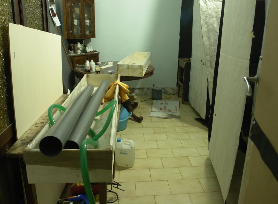

The next headache was processing. I had to do it by myself, since I was on a time/cash crunch and could not afford to pay and train an assistant. The reel to reel method that somebody suggested was the best. Here again, the simplest solution won. I used two long troughs, which I built with plywood and coated with a thick plastic foil. I used several large basins to collect chemicals and recycle as much process water as I could.
I used Ansco 130 developer and basic fixer (sodium thiosulfate + sodium sulfite). 130 is an extremely durable deverloper that yields the best tones (IMHO) and can stay in an open tray for very long times. Plain fixer was the cheapest and most archival solution, it's so cheap to buy bulk that you can discard it as often as you wish. But you have to rinse off the developer very well with plain water.
- I rolled the paper on a 80mm PVC pipe and soaked it in clean water. Then I rolled it on to a second pipe, and back, and so on.
- Dumped the clean water in a basin to be recycled, and filled the trough with very diluted developer.
- Rolled back and forth for 8 minutes
- Dumped the developer into another basin, to be put back in its container in a second time
- Used the previous water to rinse off the developer
- Second bath with clean water
- Dumped water and poured fixer in the same trough
- Fixed for 4 minutes
- Turned on white light
- Quick rinse
- Second fixer bath, 4'
- Water rinse
- Kodak Hypo clearing agent
- Second KHCA bath
- three consecutive rinses with plain water

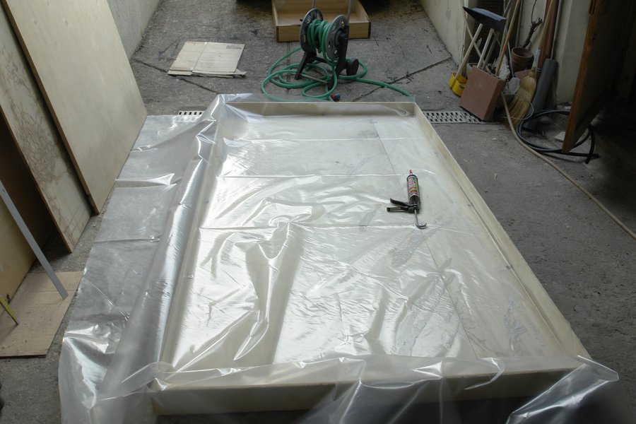

- Transported sheet and unrolled it into a tray as large as the sheet, and filled it with water.
- Let sit for 5' agitating occasionally and dumped water
- Filled again and let sit for 10' agitating occasionally
- Dumped water again, refilled and let sit for 20'
- Rolled sheet back in PVC pipe, which had been soaked in the rinsing water all the time
- Also washed the second pipe

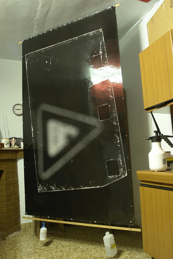

- Hung the sheet
Sistan played me a bad trick. I hung the sheet using many steel paper clips nailed to a wooden stick, and put another wooden stick with more clips and two weights to keep the sheet in tension. Sistan is very slick, so as soon as I hung the sheet, it slipped from the clips and fell on the ground! It was my first good print! After that I decided two things:
- Use pushpins to fix the paper edges to the wooden stick;
- next time I get a bad print, I process it all the way to the end, so I can experience any further mistakes and possibly save a better one from destruction.
Wouldn't it be more wise to paint the other part black or cover it temporarily with black cardboard?
That was the point. I can't avoid fogging from the paper when the sheet is in place, so in order to calculate the correct exposure/contrast on test strips, I must have the same reflecting surface as when I have the full scale sheet in place. That is why I painted it white (same reason why enlarger planes are white too, I guess).

How on earth did you get your exposure plane parallel to your film plane?
Patience, binoculars, bubble level and following the floor tiles.
Your drying set up intrigues me. How flat did the print dry? A large wet piece of fiber-based paper shrinks considerably, oftentimes pulling tacks loose. Was this a problem with your hanging dowel rod?
The prints curled on the long edges, but not too much. They did not twist or do weird stuff. I pinned them a bit loose (letting the edge make a very slight bow, not a straight line between two pins) to compensate for shrinking. They ripped just a little bit, not severely.
Of course, in order to be displayed properly they need to be mounted. I thought about pinning the wet paper on a 10mm plywood board with back ribs, folding the paper around the edges like a canvas, and let it stretch dry. But keeping it clean would be hell.
