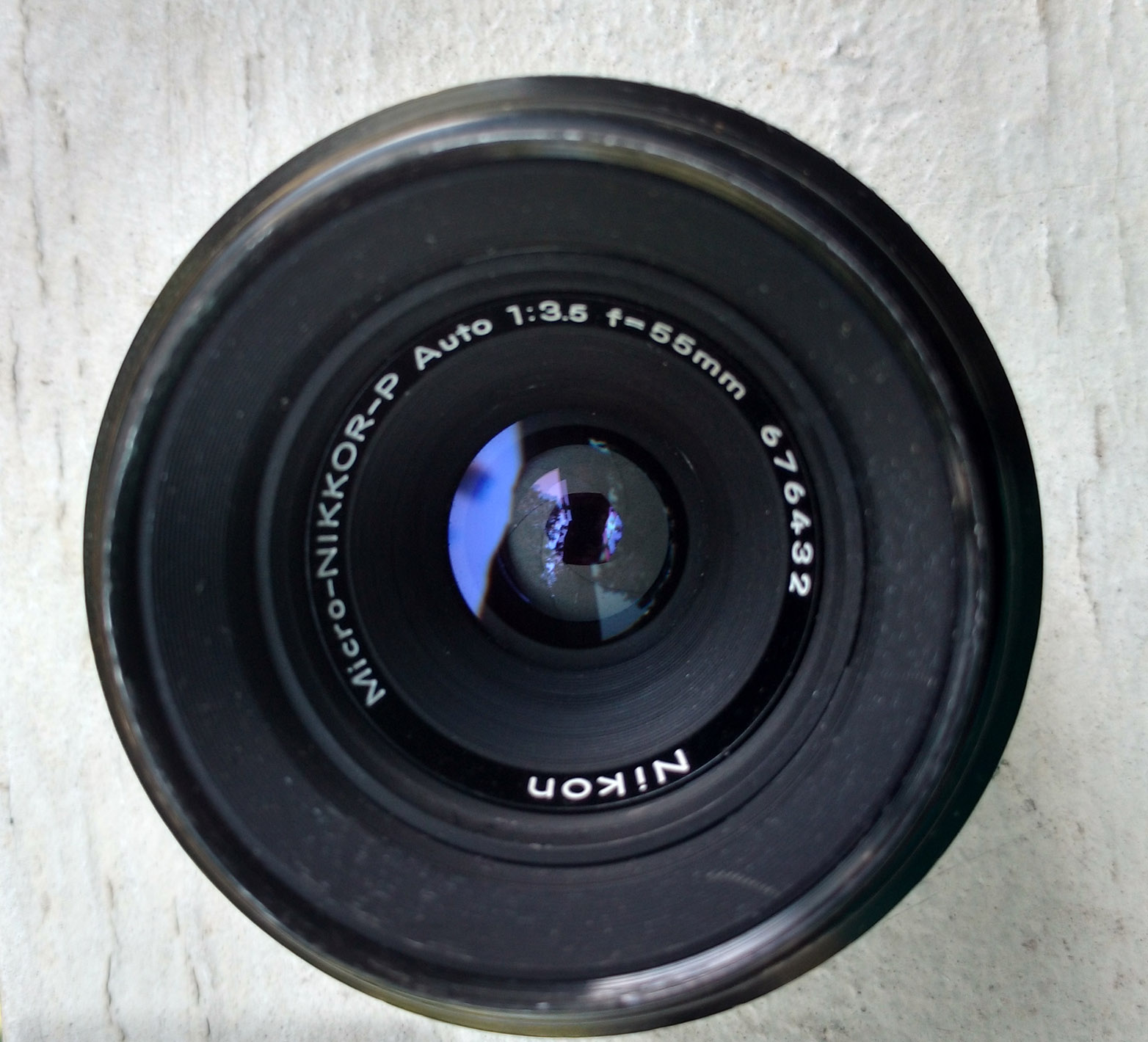

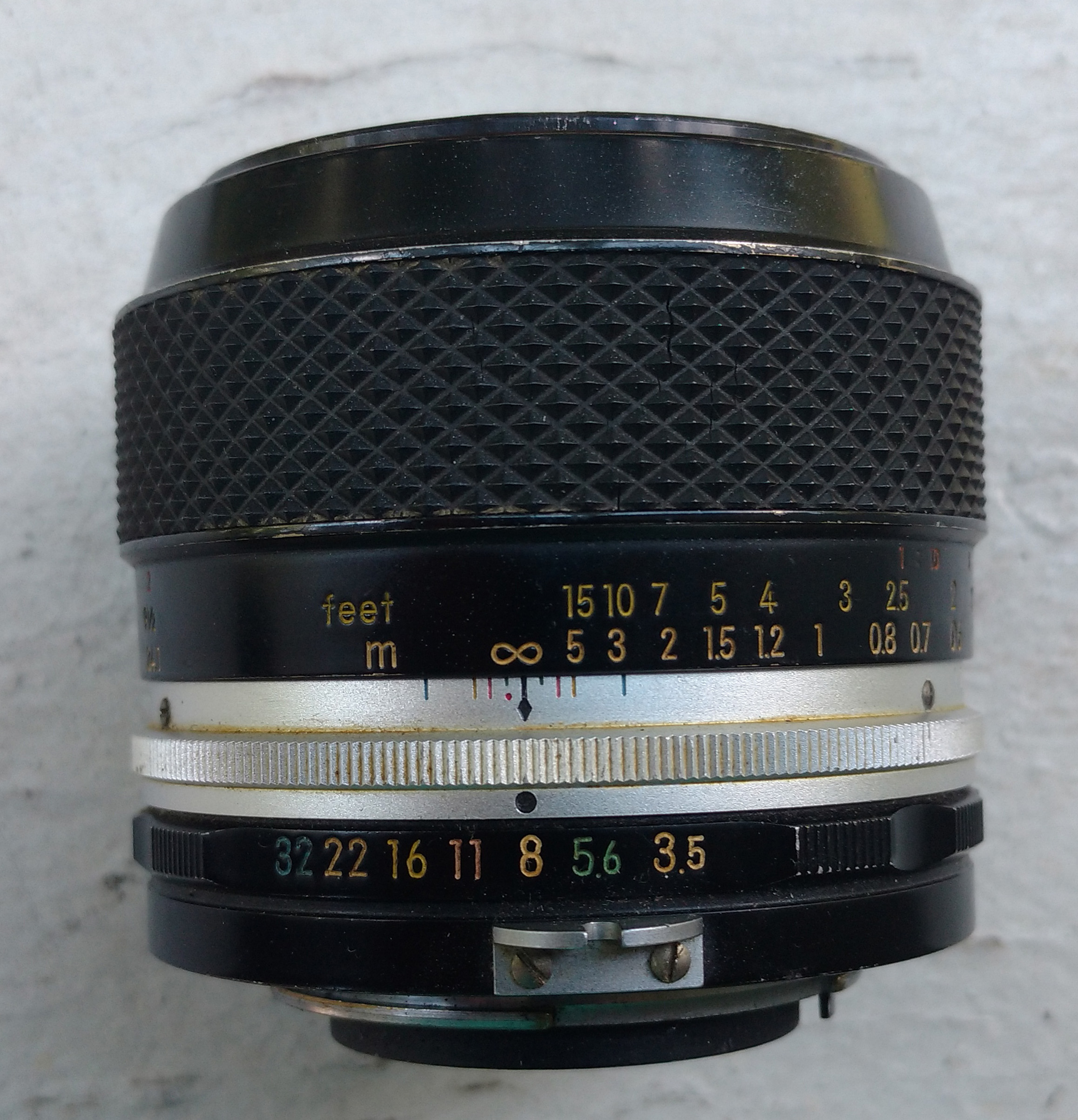

I had decided that I was going to have to give up the idea of making this lens my basic lens on my new F2 with disappointment. It was always my belief that no sharper lens was to be found, including infinity, which is the bulk of my work. In light of the latest posts, I'm posting photos of it, just to see we're all on the same page. I really don't want to steal the 50/2 off a dented FT3, because even dented, the FT3 was a somewhat rare model with only 1 production year and I like keeping things together. This 55/3.5 is an orphan in my house and I'd hoped I could have found it a happy home. But not if it can't give the kind of sharpness that can cut diamonds. So here it is:

... This 55/3.5 is an orphan in my house and I'd hoped I could have found it a happy home. But not if it can't give the kind of sharpness that can cut diamonds. ...
Why not try it with landscapes at f/8 and see what it can do?
Your 55/3.5 (diamond textured focus) is one of the versions reputed to be better at infinity than the first version(scalloped metal focus). I have this same lens and it is very good at infinity. Cut diamonds? Diamonds aren't cut, they're cleaved from rough, then the facets are polished with a lap charged with... diamond dust.
I assume you will be using apertures of f:4 to f:8 exclusively, high shutter speeds, also a sandbagged tripod, mirror lockup, specialised ultra-high resolution monochrome film, etc. because this is the only way you will see a difference between the two lenses.
