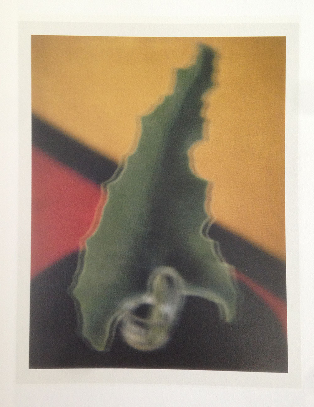

Hello everyone,
it has been a while, but I recently saw this photograph by Sarah Moon in a book and had to think about this thread here again.
What I found interesting this time is that this is an original polaroid (at least so the caption says) – meaning that all aesthetics are a result of in-camera manipulation plus polaroid colors.
Again, no idea how she achieved the silhouette around the leaf – is there a filter that doubles bright areas? Press the shutter, wait, move camera away, wait, close the shutter?
