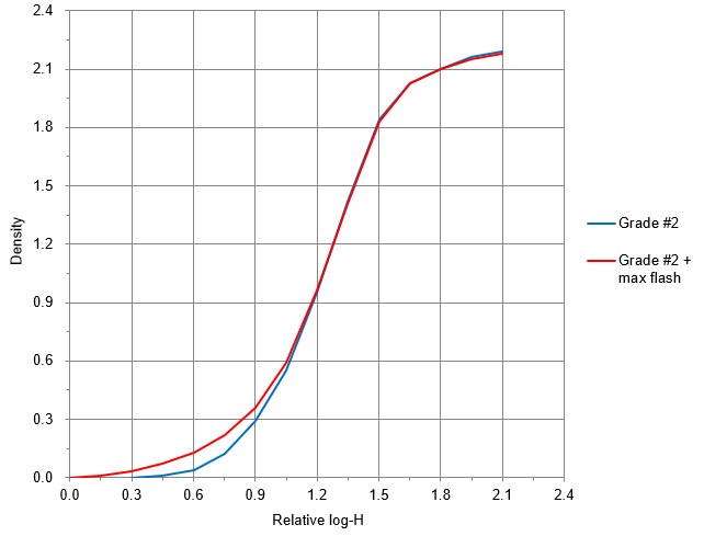

I agree with ic-racer - trial and error to find an appropriate flash time for a given paper with your setup.
Typically you would first find a flash exposure (usually the maximum non-image exposure which doesn't result in any visible density) and then do your image exposure test strips/prints on top of that.
Here's an example on Ilford MG Classic developed in Dektol. You can expect a similar effect on Lupex etc. Non-image exposure reduces toe contrast and increases threshold speed.

Yes, you need to run tests to figure out how much pre-exposure light is best for your set-up & goals. Did you find a testing method/approach somewhere or what? It's often -- after you have figured out your processing time, etc. -- to determine the maximum amount of light that creates no density at all.

First find your threshold exposure for the paper you are using. Test your pre-flash exposure like a test strip. Find the shortest one that gives you some kind of tone other than pure paper white. You'll want your pre-flash to be less than this, usually half to three-quarters of the threshold time.
Be aware that the small pre-flash exposure has proportionally more effect in the low-density areas of your print, i.e., the highlights. Think of it this way: Each stop is a doubling of exposure. Let's call our pre-flash exposure one "unit" of exposure. If that is one second (just for simplicity's sake), and that is half the threshold exposure, then two units of exposure is the paper's speed point. Four units of exposure is one stop more, eight units = two stops; 16 units = three stops, 32 units = four stops, 64 units = five stops, 128 units = six stops, 256 units = seven stops. Six or seven stops is a typical paper range.
So, you see, that one unit of pre-flash won't make much difference, percentage wise, in the exposure for the mid-tones and shadows, but has it's greatest effect in the highlights.
If your one unit of pre-flash is added to two units of exposure from the negative, though, you'll end up with density in the highlight where none or almost none would show up without the pre-flash.
Do keep in mind that pre-flashing is the same as fogging the paper, so highlight separation will suffer a bit. If you can compare a burned in area with no pre-flash to a pre-flashed area without the burning, you'll see a definite difference. The choice to use burning or pre-flashing is highly subject-dependent.

Yes, although localized flashing is often more useful, you can flash the entire sheet of paper to reduce overall contrast. It’s not going to be a huge effect, but it will definitely be noticeable. Note that when flashing, the reduction in contrast will be biased toward the highlights (refer to the graph I posted).
If you pre-expose (flash) the paper past the “threshold” where tone is produced, you will be decreasing both the paper’s exposure range and reflection density range, which will work against you.

The notion of 'inertia' is false, really. Silver halide exposure for all intents and purposes is cumulative. There is a threshold beyond which a silver grain becomes developable. If this is what you mean by 'inertia', then no, I would not recommend flashing to that level as it'll flatten out your highlights and you won't actually hit paper white anymore. This is essentially what @Milpool says above as well.
