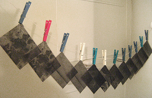

I run hot water in the shower for a few minutes and then hang the film from the shower curtain rod. I put a fancy wooden clip on the bottom of the film to keep it straight :smile:

I hang the film in the shower and close the shower door. You may want to close the bathroom door, too. Use PhotoFlo for black & white film.
Steve
This method has been bullet proof for me.

I was refering to Steve's comment which I quoted... but yes, those clothespins are indeed top of the line. =)
