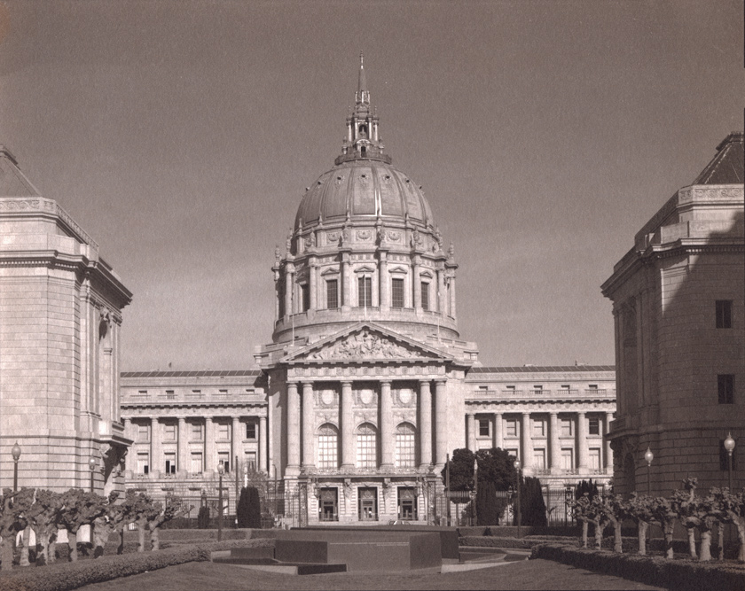

I may have this backwards but I believe that gold tones from the bottom (shadows) up and platinum from the top down. Here is a kallitype that I split-toned with gold and platinum:
Visually, gold tones from the highlights down. This was very apparent when toning some step wedges for calibration purposes. The effect can be quite strong if the print is pulled early when using a "brown" developer with 231 gold toner for Kallitypes. You would get blue-black highlights and brown shadows.
With my particular process, platinum and palladium appear to tone relatively evenly across the print. I cannot pick out if highlights or shadows are effected first.
I've never found a satisfactory theoretical explanation for this, nor have I been able to demonstrate it. Toners affect the metallic image. They don't care at what part of the curve that metal happens to be.
I think what likely happens is that with some toners, we more easily see the change in hue in the highlights, while with other hues, the shadow changes are more apparent at first. This phenomenon then might have found its way into common parlance, confusing the subjective impression with a physical/chemical mechanism. I think the two should not be confused, especially not in the context of this specific question.
This is my understanding as well. All areas are effected equally, but depending on the toner (or bleach) certain areas will show color change before others due to the density thus giving the illusion that highlights or shadows are affected first.
Yes, precisely; I can also see how this visual effect can easily be mistaken for a differential rate in physical metal replacement, but as said, I've never seen good empirical or theoretical support for this.
