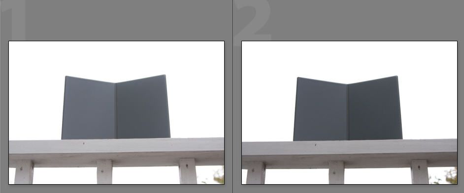

OK, I have overcast skies, unlike my earlier examples, but I shot anyway. In this example, I have quanitified the 18% gray card as filling about 17-20% of the frame area, more in line with the estimates of EOS 1N metering pattern in Evaluative.
Much closer, but Evaluative still underexposes a bit (shot 2) because it is fooled by the sky. but much better that the original test.
