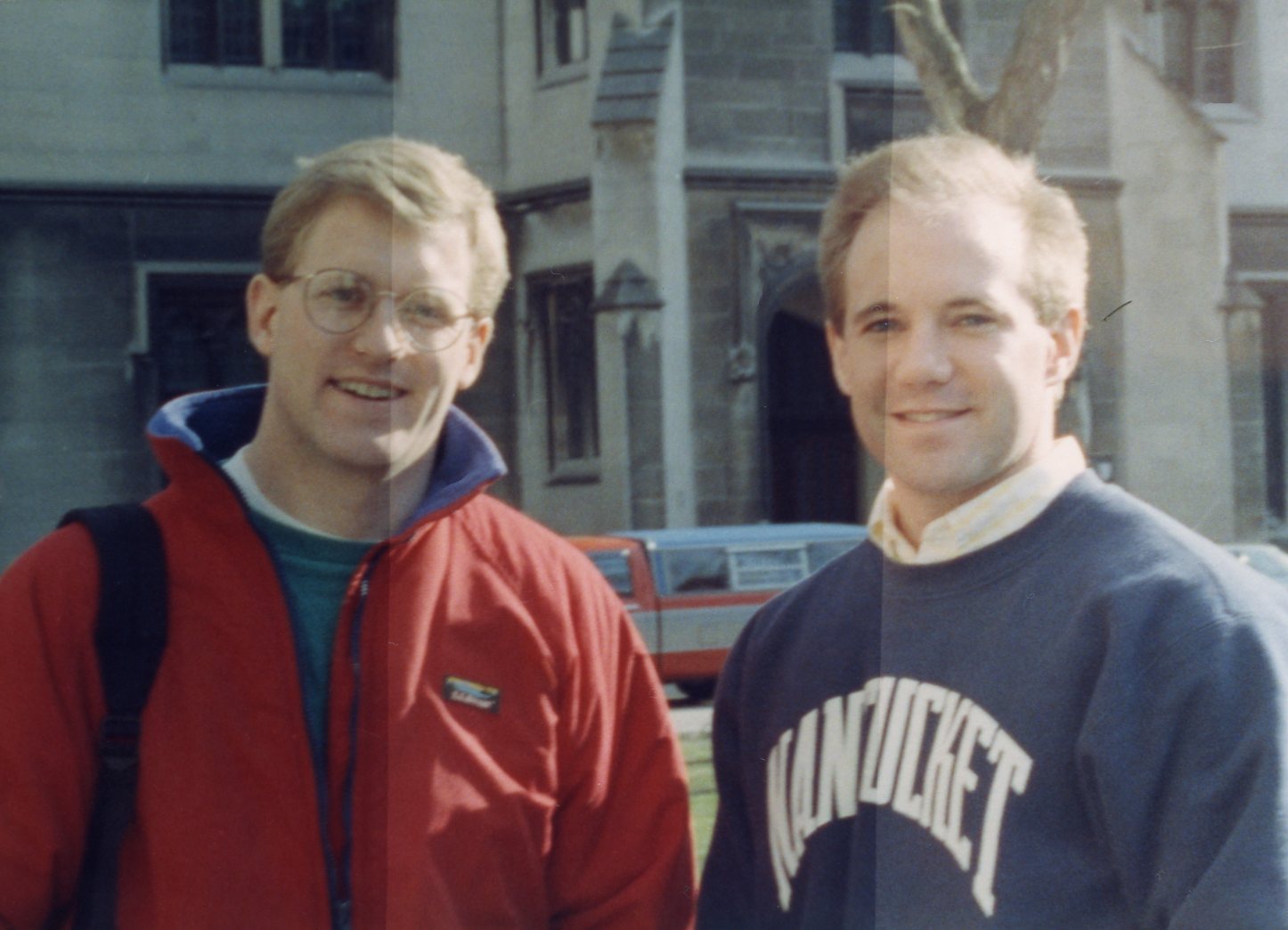

Attached is the test print with the paper I struggle with.
Enlarger: Saunders 4550
Schneider Componon-S F2.8 55mm stop at F11
Fuji PIII paper, probably 4 years old
RA-4 chemicals are good, tested with Fuji Super C paper
Filter setting: 57Y/22M.
Exposure time 25/20/15 seconds
Old Kodak film (gold or max?)
8x10 enlarging from 35mm
I'm not sure if the print quality is acceptable. To me, the contrast is still too low. Colors get much better. The exposure time is very long. With my Fuji Super C paper, the exposure time is 16 seconds at F16 stop.
Is this paper good? or the images say the paper is too old?

I'd open up a stop and try 13 seconds, you might have some motion blur and diffraction from using f11. Without seeing the real print, it's hard to tell if it has a problem or not, from the scan it looks halfway decent. I try to keep exposures around 8-12 sec, even replacing the 250w bulb wit an 80 w one for small prints.
