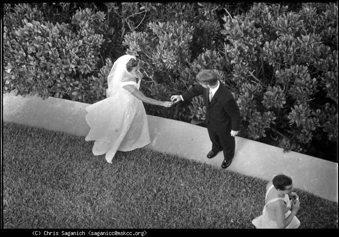

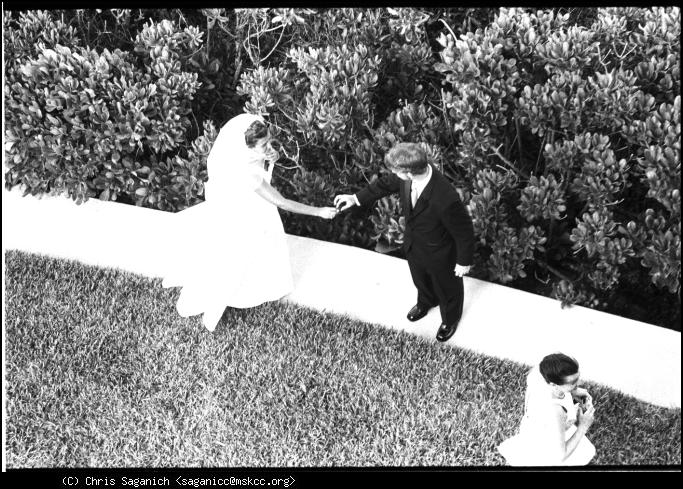

Hi Vetus,
I agree with Koraks, you can usually print through fine if it's a case of overexposure. The shutter speed dial on my camera was malfunctioning during some wedding shots resulting in overexposure. I applied negative reduction using a Formulary kit just because I never tried it befor. Work pretty well. You can see despite the overexposure there was still detail in the dress that would have likely printed ok. The proportion of the A B mixture affects the reduction...equal measures (1:1) will act as a proportional reducer which acts on high and low density areas the same amount. A 1:3, for example, will act as a super proportional reducer which will act faster on the densest areas of the negative. If I would do it again i would try 1:5 or 1:8
