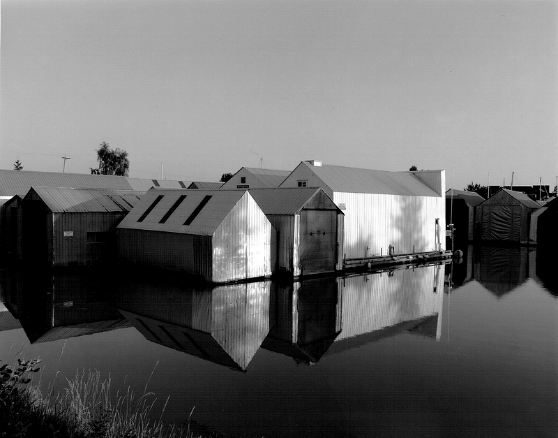

This looks great on Cooltone:
That is a nice image and the metal would likely really sparkle on that paper.
