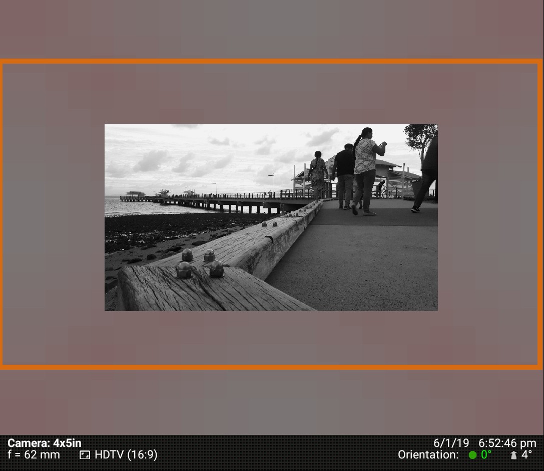

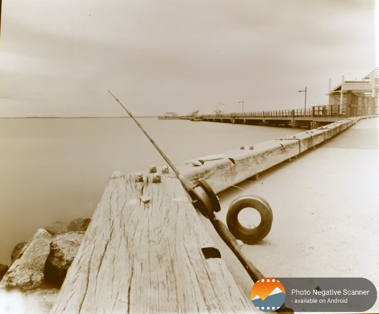

You can also use a View finder app on your phone, set the angle of view and aspect ratio and can even have it in mono.
So a photo like this
Becomes like this, simply by tilting the camera forwards (used a few stones under the rear) to emphasizing the foreground and have the end of the jetty squeezing into the horizon..
Thanks for the suggestion I’ll look into
I might opt out the app but it’s good to know it’s existing; it could come handy in certain situations later on, so thank you!
