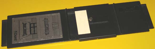

The disadvantage is I cannot measure the same portion of negative for each exposure
Along with the DIY solution, above, Durst made a printer that allows this. A little sliding shutter door advances the paper and covers it between exposures. You can either make x tests of the same spot or move the printer between spots and do several mini-tests over the surface of the print. No longer available, it may give some ideas if you are making one for yourself.
