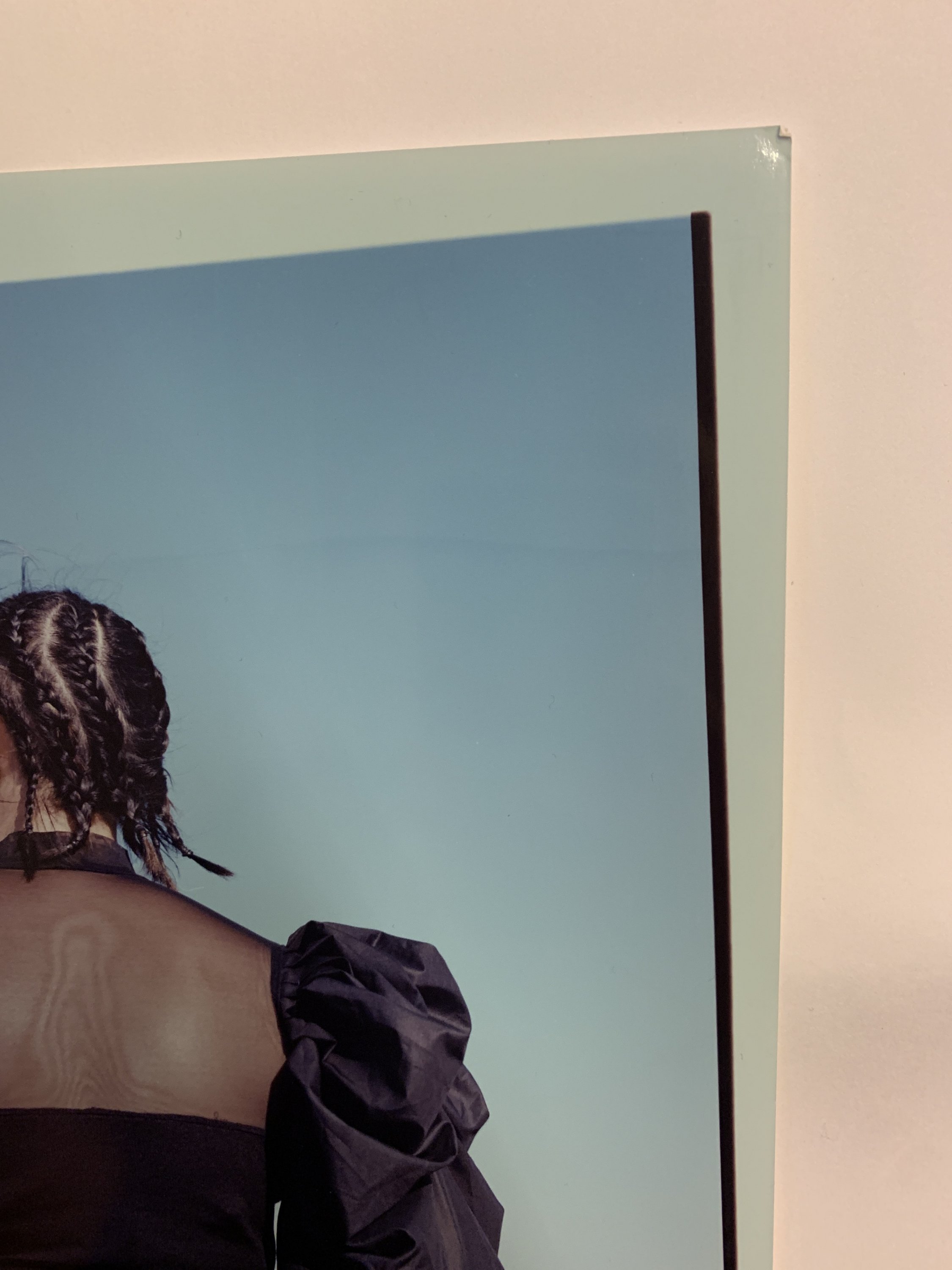

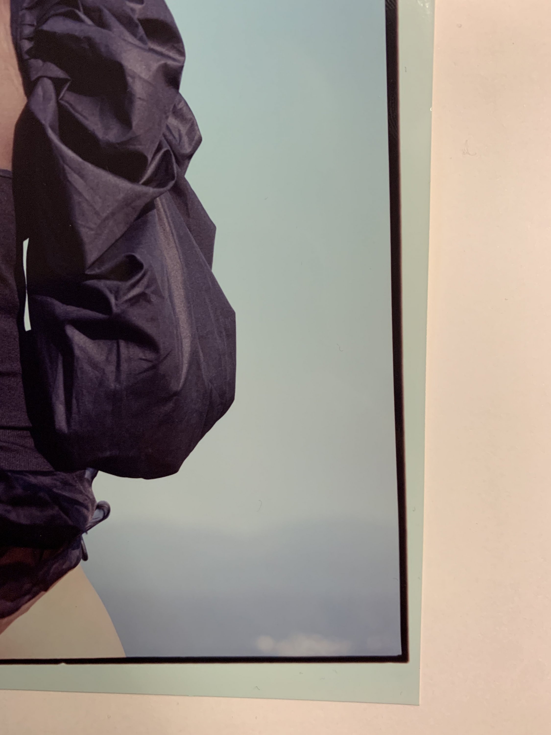

I started getting cyan edges on my prints, after using the same blix for more than two 8x10" prints.
I’m using a 8x10” Unicolor drum to process my prints on a rotary base.
My process is pre-wash 40” > dev 2’ > blix 2’ > rinse 4 times 1’ > continuous wash for 4’
I’m using Tetenal RA-4 Kit with Fuji Crystal Archive II paper.
The cyan cast doesn’t seem to affect the image, it just covers the edges.
When I change to new blix, it’s not there anymore.
