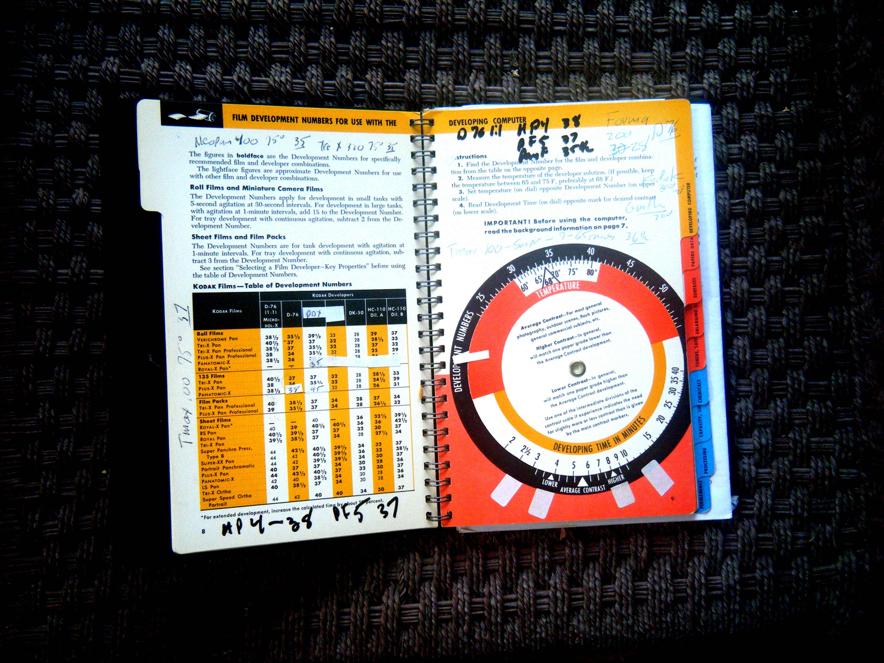

I use the standard Kodak agitation scheme. To increase or decrease contrast, I adjust the time and temp, still use my Kodak Black and White data guide, not sure of date of publication, sometime in the 60s. For those who have not seen one there as wheel that shows times for Kodak films compensated for contrast. I've added times for many films, Foma, Ultrafine, with developers
other than Kodak. Seems to still work.

I use the standard Kodak agitation scheme. To increase or decrease contrast, I adjust the time and temp, still use my Kodak Black and White data guide, not sure of date of publication, sometime in the 60s. For those who have not seen one there as wheel that shows times for Kodak films compensated for contrast. I've added times for many films, Foma, Ultrafine, with developers View attachment 279679 other than Kodak. Seems to still work.
I grew up with one of these, my Dad had one, black cover, early 60's late 50s. We didn't have a fancy inversion tank. I bought a new Paterson tank c.1970
