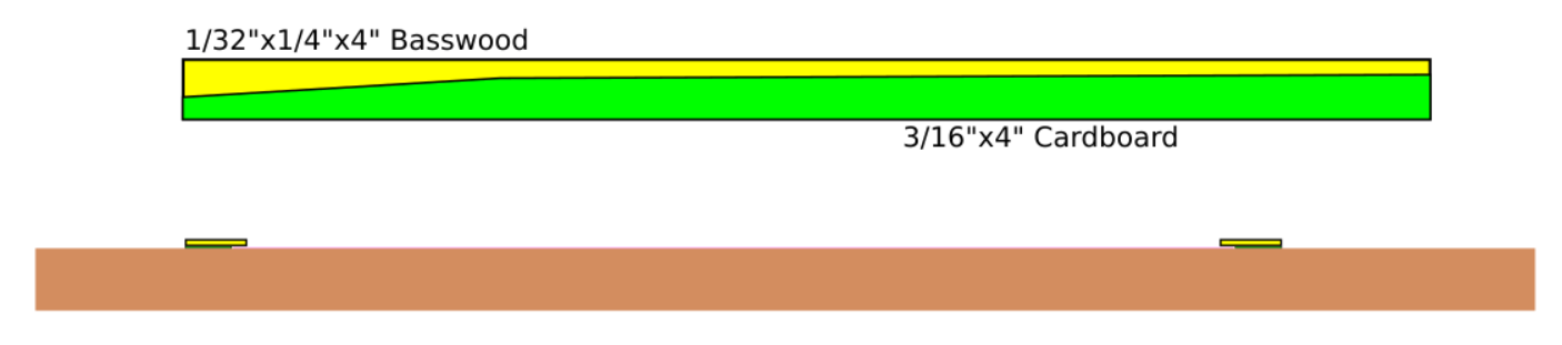

This is what I have figured out so far:
I can get basswood from the art supply store in strips 1/32"x1/4"x24" (have to buy five to get the one I need)
I have a sheet of 4"x5" cardboard that came with Fomapan film and is thicker than a sheet of film
I can cut the cardboard to the green shape and mount the strips slightly more than 4" apart
The beveled corner will help to get the film started between strips
Then I attach a strip of basswood so that it hangs over the film by 1/16"
In essence I am creating the tracks of a film holder
