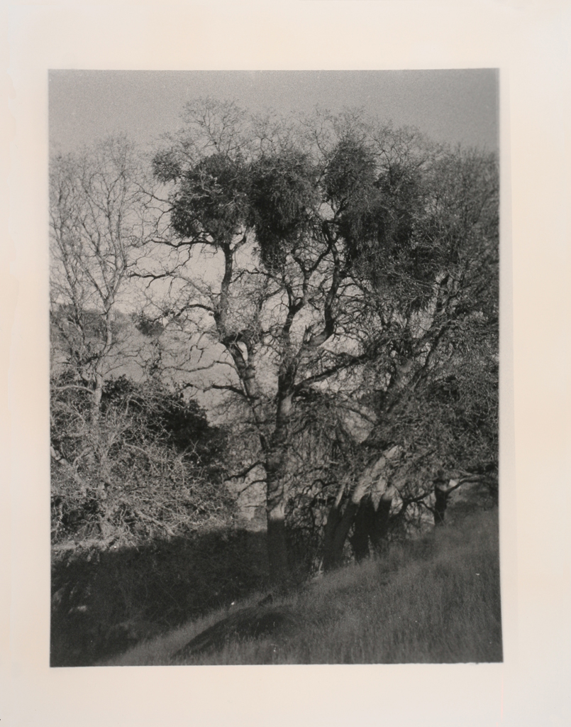

NedL
Aug 23, 2012
3,390
Sonoma County, California
I was thinking of more extreme things like lighting your darkroom on fire, or putting the print through a paper shredder then scotch taping it back together, or burying the print underground for a few months, or running it over with your car, put it in the dishwasher , use arc-welder, sledgehammer, grinder, sander, jackhammer, steamroller .... but I do agree if you don't wash your print well enough after fixing, it will stain in the KRST! :D
