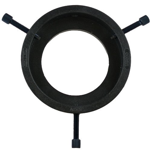

image.jpeg For small lenses without a thread I use a Universal Adapter Ring made by Cokin, it's called A275. Too small for your 85mm diameter, of course, but maybe you could make or find something similar.
