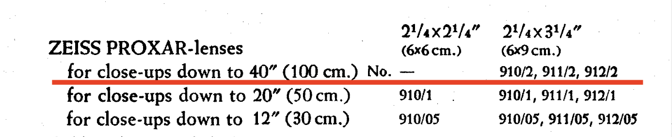

I have a copy of a 1954 Zeiss catalog that mentions "Proxar" lenses. At that time, the current Nettar model was the 518/2, the next model after mine. Apparently the 105/6.3 Novar was still an option for the Nettar, and I assume the lens was not significantly different from what came on the 517/2. The catalog shows this chart under the Signal Nettar 518/2:
So it looks like I want a Zeiss Proxar 910/2,911/2, or 912/2. However, I have been unable to locate any listings for 32mm push on Proxars using these specific numbers.
I believe the the "2" in the part numbers refers to the diopter. So I am wondering, will ANY close-up lens that I can make fit, and which has a +2 diopter, also allow my Novar lens to focus down to 40"?
No ! A 2 diopter auxiliary lens would focus at 0.5m (with the main lens focused at infinity) and closer (with main lens focused "closer than infinity"). From the catalog excerpt that you show, I would say the "2" is the focus distance --metric-- with main lens set at infinity. The closest focus distance shown the table is with the main lens set for minimum focus distance; that being 2m, as this would result in combined focus at 1m.
Thanks for the clarification. I have been trying to read some of the old Zeiss literature about Proxars and Distars, and I am confused by the terminology (obviously). I grew up with 35mm SLRs and "close-up filters" which were marked in diopters. But with SLR cameras, I could always see what I was doing, so never felt the need to learn the math.
I would advise not to invest time/money/energy into close-focus photography with such a camera if you are not comfortable with diopter calculations. And, calculations aside, this will be impractical and slow.
