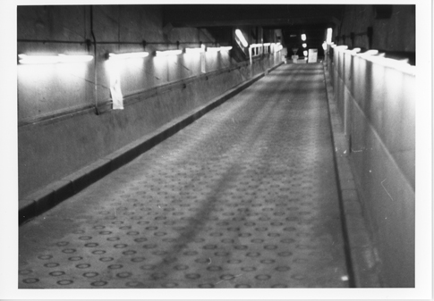

Last night I played around in the darkroom for a while. I adjusted the easel to accommodate one half of the frame, and it worked well. The print below isn't the best, but it worked and I got about 5 or 6 ones that I'm happy with.
I printed on 12x16.5cm / 4 3/4x6 1/2 sheets (known as "Kabine" size in Japan.) What's the largest that most people enlarge/enlarged half-frame to?
