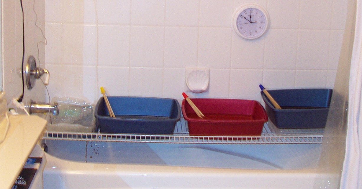

For washing I do much what others do but have an additional challenge in that I don't have a sink anywhere in the house large enough for an 8x10 much less 11x14 tray. I suppose I could use the bathtub but that's low and very awkward.
If you have a bathtub with a flat topped rim, an inexpensive wire shelf laid on top can solve this problem:
Good suggestion but it doesn't really work with the garden tub in my master bath, I think. It's not that it isn't flat topped, rather that the front of it has a step and is too wide - it's a LONG reach back to the water unless you are in the tub. The "normal" tub in the guest bath would work, but my fiance has pretty well commandeered that bath room. :smile: I'll get running water in the basement within a year, I hope.

I too just set up a darkroom in my apt. I cut a plywood board, with slats UNDERNEATH otherwise the whole thing falls in the tub! ;>
8x10 trays fit nice on it. 11 by 14 u have to put two sideways. Drill holes in it so the water runs out the spigot side. and put doorstops under the wash tray so water runs to the left.
I keep rinsing down the tub as i'm working but any stains u can wipe off. Develper will be brown found out this am.
I cut a plastic hose over the spigot and put hole in it so a big droom thermometer stays there.
Even w/ the fan on it gets hot in there tho. wow. Wear a bandana!
