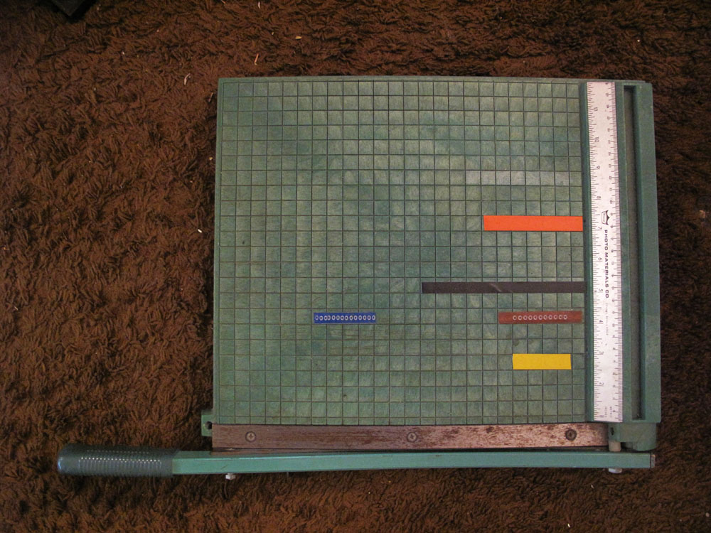

I use a regular guillotine cutter marked with the old style Dymo labeling tape for my most used sizes. Note that I even used the label maker to make "Braille" marks on a couple of sizes.
I do the exact same thing for cutting down sheet film from 8x10 to whole plate format.
