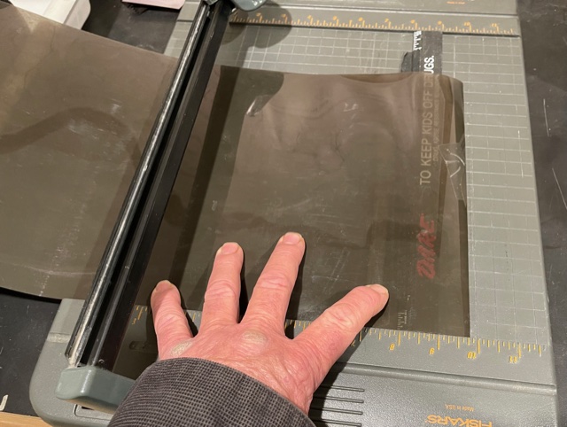

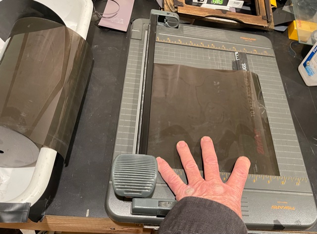

Here's how I've done it for at least 15 years. Expect dust and other artifacts, it isn't perfect!

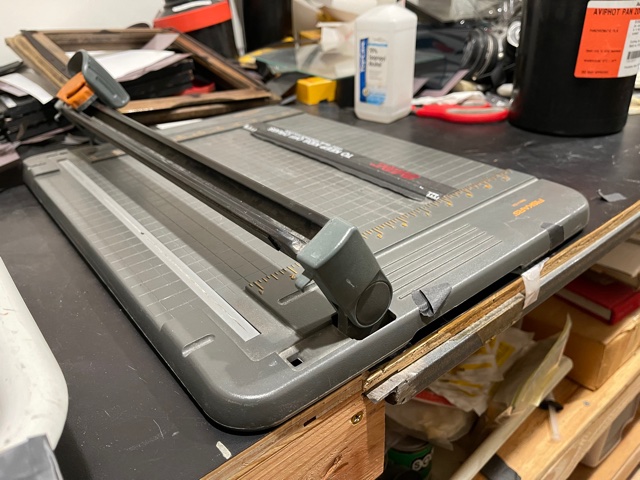

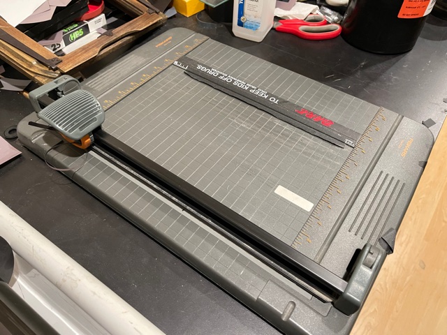

This cheap Fiskars roll cutter works the best. A standard 12" ruler fits tight between the top and bottom edge. Then a piece of black masking tape keeps the film from slipping under the ruler giving a positive stop at my just less than 8 inch width. Notice the film long roll in the tray. Keeps it lined up so the film rolls out and rides parallel with the cutters edge to give a perfect 90 degree cut.
I roll out over the ruler and do the 10" length cut first. In the dark you can click your fingernail in the slots and know where that edge is at. A bit less than 10". Make your first cut from the roll here.
Then flip it 90 degrees and set the edge against the ruler for the 8"cut

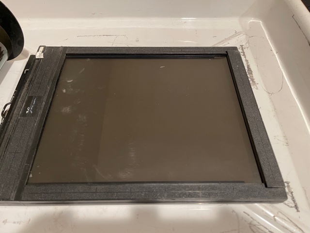

You now have a nice 8X10 sheet ready to load. No notches needed, it curls into the emulsion.
Ready to shoot. It gets easy after about a million times. I can do it in the dark.

You got a roller knive where one can lift up the bridge with the roller. First time I see such. Over here offered are roller knives with a static bridge and a pressure strip that obly yields a very tiny slit which then is tightened by the roller running over. Such design is not not made with scratch sensitive foils in mind. Here the alternative are guillotine knives, where there is a rather wide gap under the pressure strut when the knive is still up.
Cutters and roll holders completely from metal likely reduce the artifacts from static dust.
jimgalli
jimgalli
Sep 7, 2002
4,232
Tonopah Neva
ULarge Format
The bridge with roller holds the film steady during the cut. It never marks the film. It has worked very well for 15 years. I’ve replaced the roller blade one time. Supposedly self sharpens I think.

I use that same cutter to cut 3 1/4 x4 1/4
I placed small strips of Dyno label tape in appropriate places on the cutter bed to act as stops
