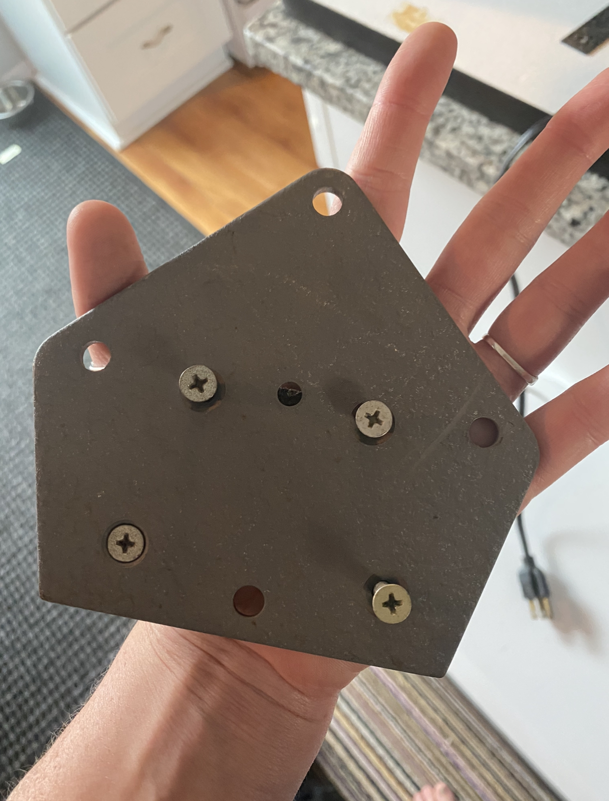

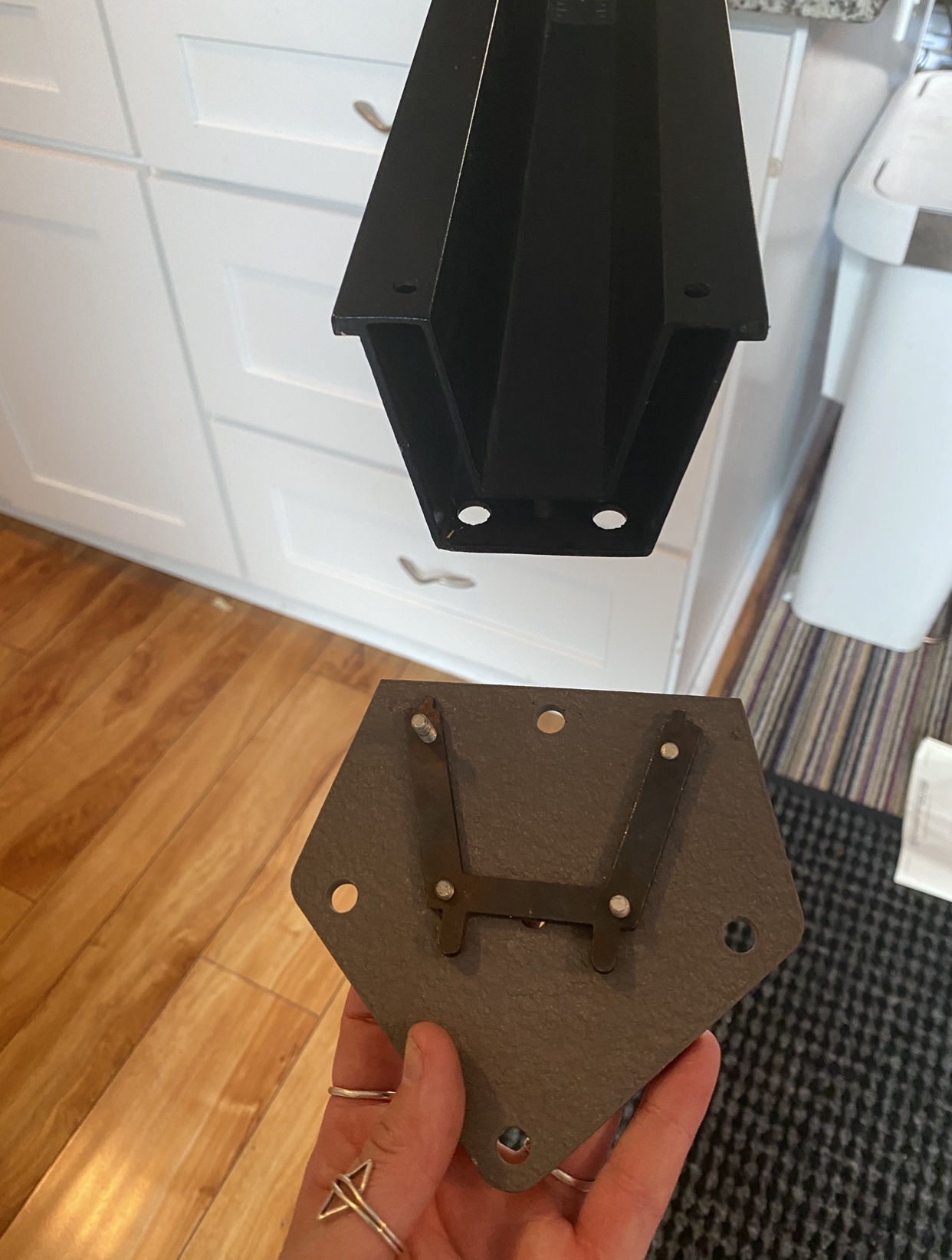

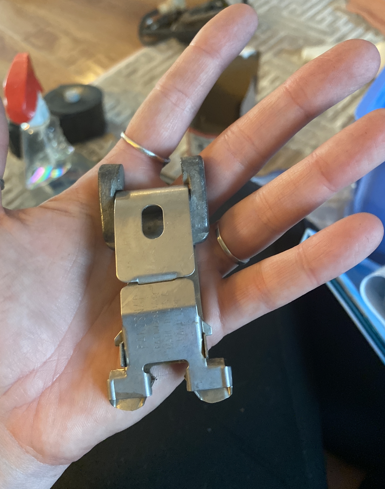

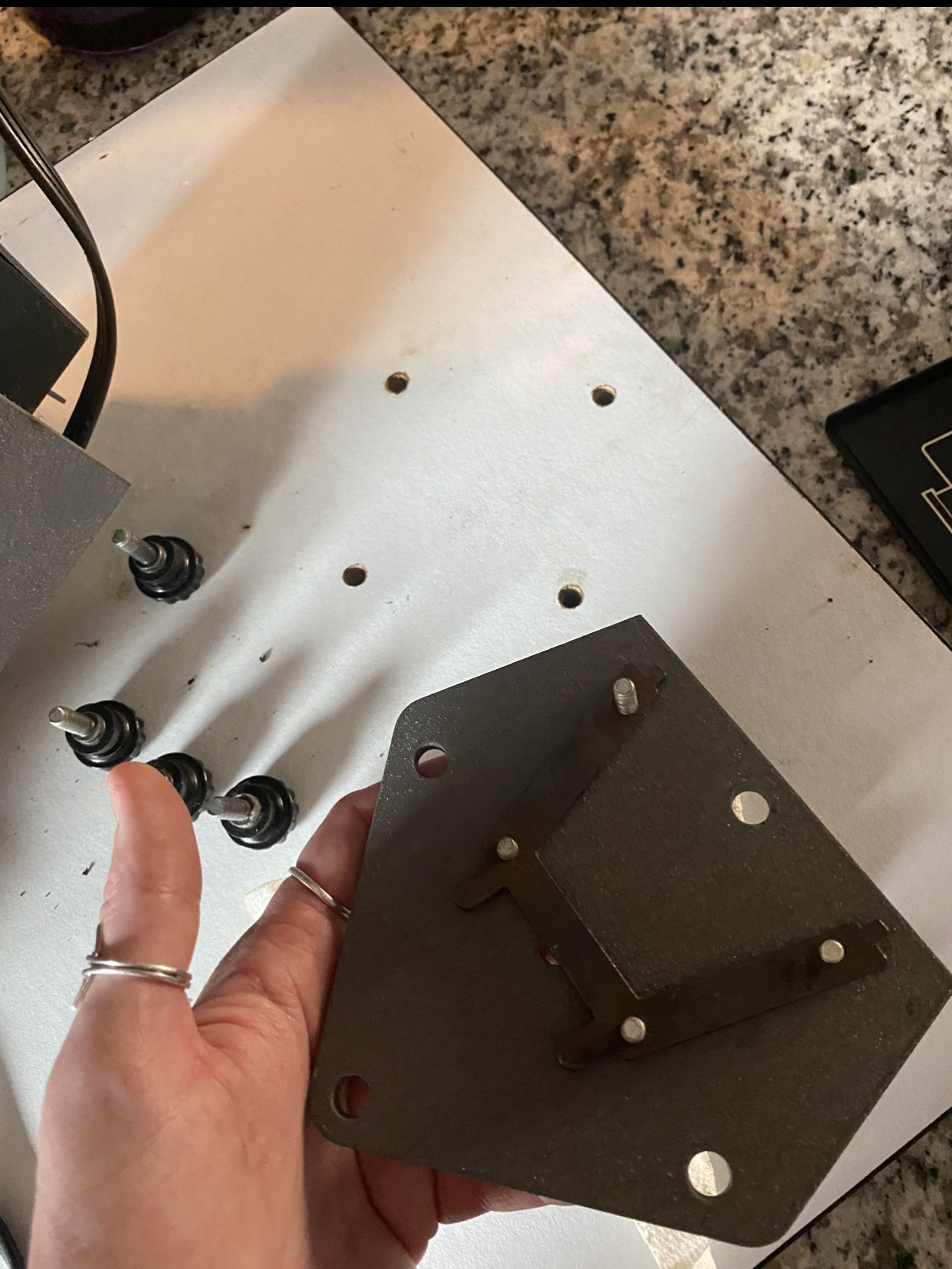

Hi! I have been scanning these forums for this and I have come up short.
I have a baseboard, all screws/ pegs to it, the full enlarger with lighthouse but I can’t seem to tell if I am missing a piece for it to attach to baseboard. Attached as some images, does anyone have a spec sheet or a how-to I stalled these two pieces? I found a random piece in the darkroom box I got from a friend and am not sure if this even goes to it.

To get that "U" piece back into the column, it looks like you feed the two long protrusions of the "U" shaped bracket into the two larger holes on the column, then slide it back to engage to two small holes.
