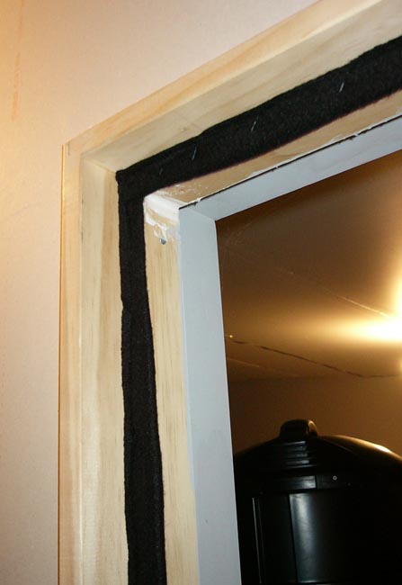

I put a frame of wood around the inside of the door frame then stapled black felt around the edge where the door makes contact. It is 100% light tight. I included a few snaps so you can see.

I forgot to mention my frame goes all the way around the door including the bottom, the bottom part of the frame had a larger gap so I used about a 2inch tall piece for the bottom part.
So, in other words, you have to 'watch your step' to avoid tripping as you go into the room?
