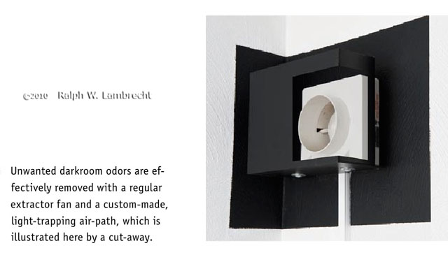

No. To maintain total darkness AND ventilation, you are advised to build light traps. You'll find plan on the web or in good books. Light does not go around corners, air does.

You can install an inexpensive bathroom exhaust and duct it outside, also install a wall vent(or two) that is light tight(as per Ralph L.). I would put one intake vent near the ceiling, and another near the floor, and a power exhaust in the ceiling. Make sure to place the 'in' at the opposite end of the room from the 'out'. A weather seal around the door will help to shut out light. When you are finished, sit in the darkened room for at least five minutes before checking for light leaks.
Rick

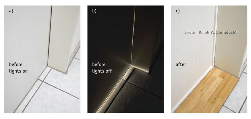

I have some minor light leaks under the door of my darkroom that in almost 20 years of use have never lead to fogging. It takes me a minute or two of complete darkness to see them. However, when loading film onto reels, I don't want to take any chances and either make certain that the "minor" leak is sealed or that it is dark outside of the darkroom.
May that as it be. It is extremely easy to make doors totally light proof. I suggest to stay away from seals of any kind and use a light trap design instead. An extra piece of wood, painted black on the exposed sides does not conflict with the operation of the door but prevents any light to come in.
