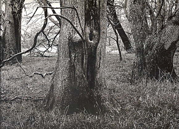

My times with Tri X are 6 min 15 seconds with dilution B. The attached image is made from a Tri X negative developed as indicated and printed on grade two. To answer your earlier question of how to develop a print at grade one or two, increase the density range of your negatives. That means increasing time, agitation, temperature or decreasing the developer dilution.

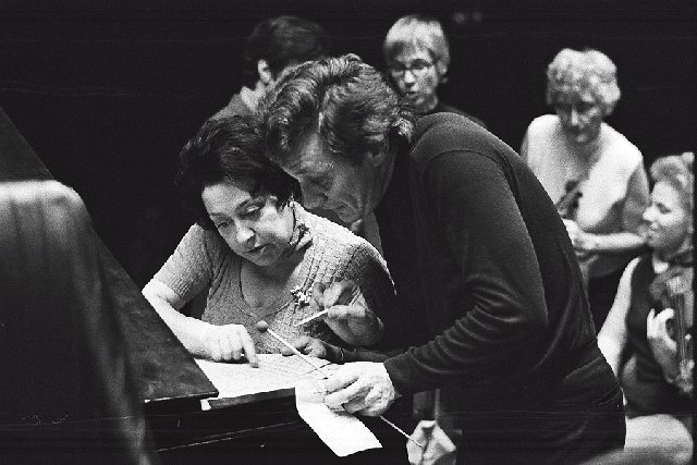

The attached photo is of Alicia Delarocha (sp?) taken around 1970 when she was a guest of the Norfolk Symphony, now known as the Virginia Symphony. It could have been developed in one of several developers. I didn't keep that kind of record. I do know that I used 1/60 at f/2.8 for all my pictures. The paper grade is of no consequence here because this jpg was scanned from the original negative. The picture doesn't prove a lot, but it does show what is possible. It might have been more enlightening if I had scanned a print from that negative. If anyone wants, I will do that next time.
