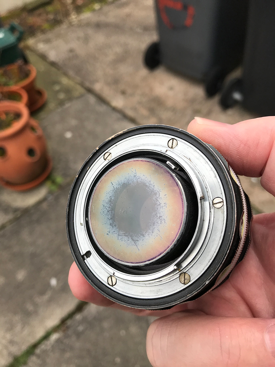

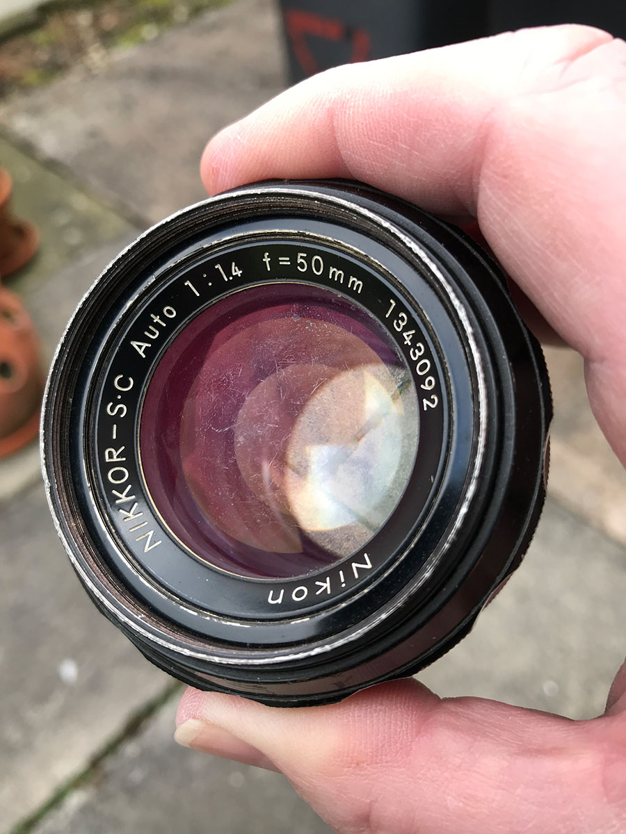

Another way to remove coatings is to have somebody else do it for you, these are a Nikon 50mm from a newspaper photography department supply cupboard, they didn't bother with lens caps
