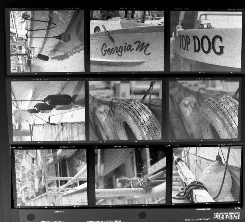

By the way, a digital camera and a light box can make a quick and easy low quality negative proofer - so digital workflows can coexist with the darkroom:
