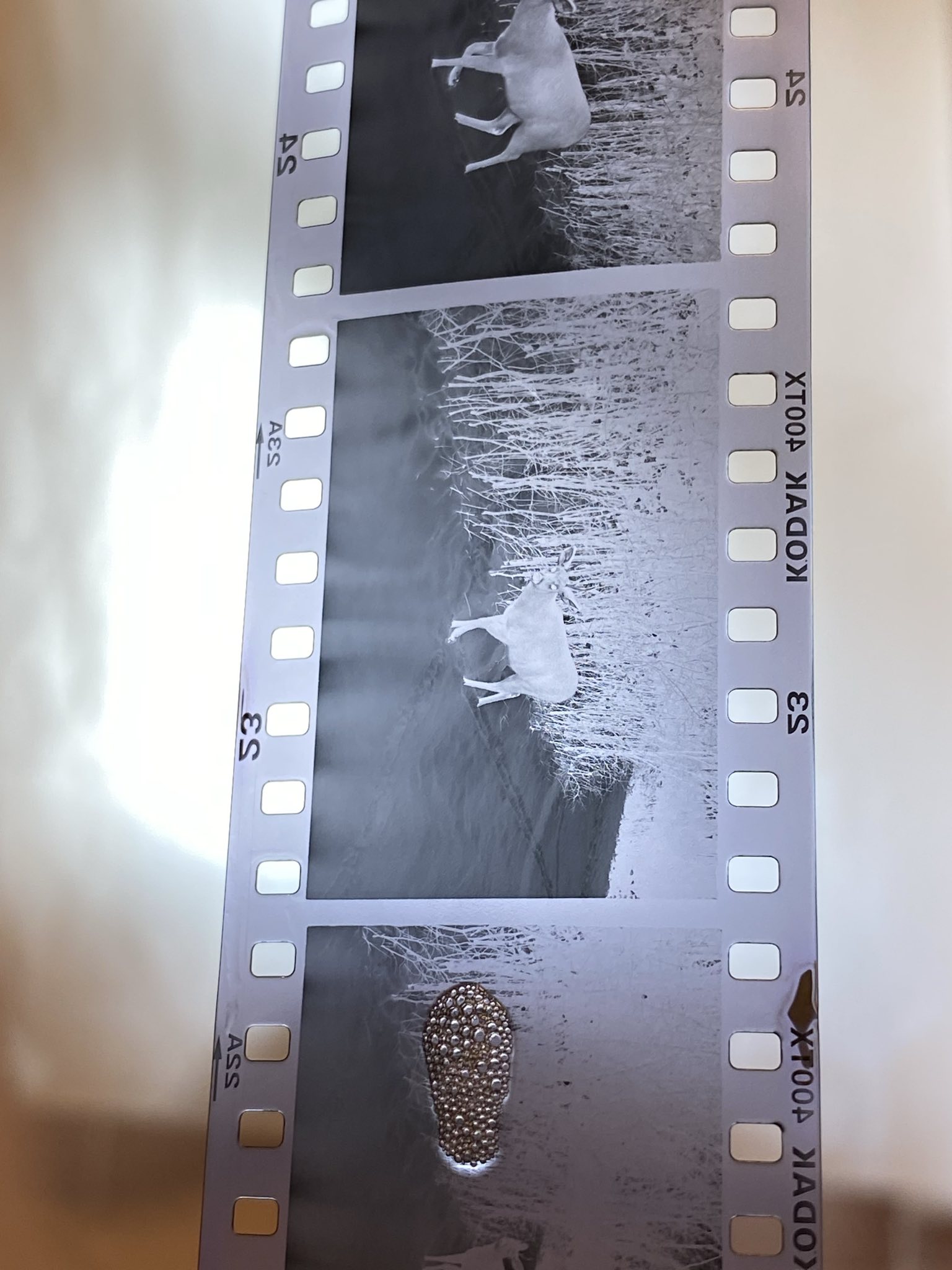

I tried Diafine for the first time today. Followed the instructions, mixing with distilled water. As recommended, I did not do any pre-soak, and no wash between Part A and Part B. I did each part for 4 minutes around 75F with no agitation. 3 reel Paterson hand tank.
Was that the problem, do I need to agitate? This reminds me of effects I have gotten with full stand development. But I thought the recommendation was not to agitate with Diafine.

You see the typical problem with stand development. I don´t understand why this has become so common now. You need agitation.

Zero agitation = bromide drift/sprocket hole streaks.
You agitate as you're meant to and the problem goes away. There's a reason why manufacturers state an agitation protocol for developers.

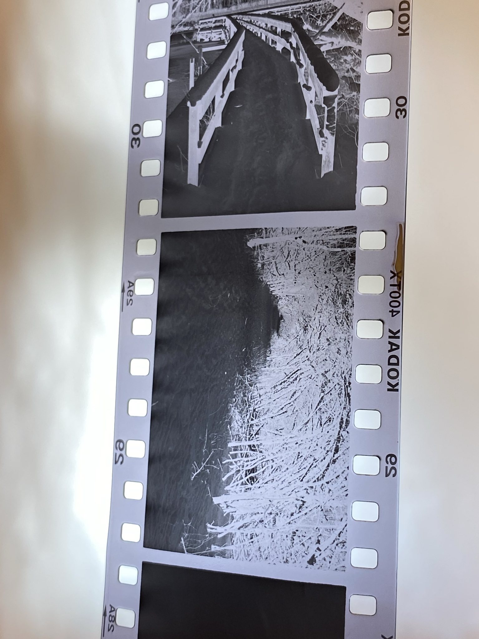

I'm no DIAFINE expert, but with divided development, the PART A simply gets some of the developer into the film through absorption into the emulsion. Agitation for that part may not be necessary -- unless DIAFINE says otherwise. Even the time is not that critical -- so long as it's long enough for the film emulsion to absorb as much as it can of the developer.
It's PART B where the development actually happens -- thanks to the action of the other chemicals -- and "bromide drag" can happen, thanks to gravity, without adequate agitation. If you are using sheet film in a tray, for example, you can get away without agitation. I think Ansel Adams mentions this. It's the time in PART B that will control the Contrast Index.
P.S. What's that amoeba thing in your negatives?

I have used Diafine on and off since 1969, you do have to agitate. Also the temperature thing has to be within reason. I used 72F on mine and 4-5 min. It did great with Kodak Tri X and Ilford Pan F. When Plus X was here it was also great.

After a couple of decades I am now using Diafine, as you have discovered there is a fine dividing line of how long and when to agitate. I use the original directions from the 70s, 5 second agitation to start then 5 seconds every minute both A and B. I tossed the last bag I mixed, still have box from the 70s, is there any update. I generally go 4 minutes A and B. I should have saved the bag as the times for Tmax 100 seemed to be someodd with a differnt time in A than B.

Yeah, I had come across a 20 year old thread when using a web search about it where a lot of people were saying you didn't need to agitate. It made sense to me not having used a two-part developer before, because my understanding was they would develop "to completion" and then stop, so the idea of uneven development didn't even occur to me as a possibility.
I can see now that's not quite how it works, and these two-part developers have more in common with the standard kind.
Reading the manufacturers instructions on the packet, I saw the 5 seconds initial agitation but skimmed over the 5 seconds per minute part a bit too fast. Attention deficit I suppose. I threw out the packet after I mixed it because I don't like to keep powdery residues around, so that was my one and only chance to read it before development.

Newer emulsions such as Tmax and Delta, as I understand it are somewhat harder than older types and require additional time and agitation. As Trix has been updated as late at the mid 2000 it might have a harder emulsion as well.
