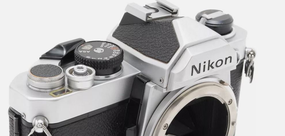

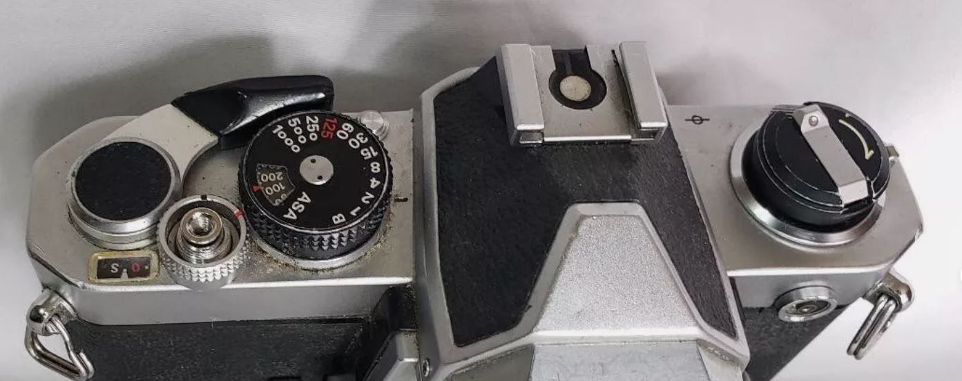

My 2nd gen Nikon FM (two knurled) bites the dust and the shop tech said he would not bother repairing it. He said he has to remove the mirror box to access the suspected part and if it is worn out he can't get a new or NOS replacement part anyway. Furthermore he explained that on the 3rd gen FM (one knurled) Nikon moved that mechanism to be more accessible from the bottom. From what he described the mechanism is the double exposure prevention.
Besides that, Nikon also integrated the shutter lock to the wind lever mechanism on the 3rd gen, so the top cover looks identical except it doesn't have shutter lock. I found a beat up working 3rd gen FM for sale online and I wonder if I can still replace the top cover with the better cover from my 2nd gen. I am thinking I may have to shave the protruding part on the bottom side of the shutter lock on the 2nd gen but other than that what else will make the cover swap impossible?
I know there will be replies like : "just buy a nicer 3rd gen" which I will completely disregard for the sake of tinkering freedom.
Of course there are spare parts, they don't have to be new, they just have to be in clearly better condition than the part being replaced.
There are plenty of cameras that can be dismantled, but that is a lot of additional work and costs money.
Another reason to opt for DIY.

I completely forgot that I had a 3rd gen FM and I sold it cause I hated the fact that the advance lever had to be opened and poked my forehead. So I cancelled this idea.
Anyway, I opened the camera and fixed it. The cause of the jam was the camera was in half cocked position. I also found the previous repair guy put the wrong shutter button retaining screw and didn't put the small plastic pin on the hot shoe assembly causing it to malfunction.
