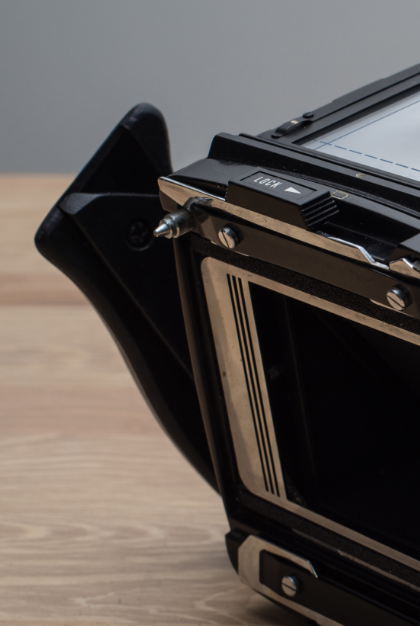

Now this may seem kind of strange, but I did not find the original Mamiya grip worked particularly well for hand holding with the prism or sports finder. Instead, I built my own. For me, the best solution was to have my left hand hold a vertical pistol grip tilted backwards and at the rear of the camera, then use my right hand to support the bottom of the camera. I used my thumb to focus and my index finder to release the shutter, or fed a cable release into the grip. It was a great setup, the only reason I don't have it any more is because I want a more compact and transportable system with movements (essentially a folding 2x3 press camera).
