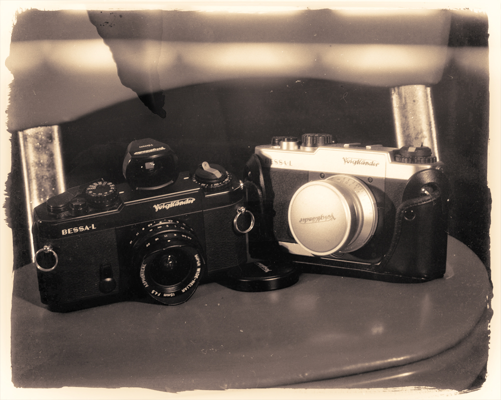

I've got the 25mm CV LTM on a Bessa L and like it alot. Nice clear focused pictures somewhat slow at f4 but the size makes up for it. Have the 15mm too and can't go wrong for the price on either I would say. I don't use filters but I believe the 25 is 39mm and it comes with a small hood attached
