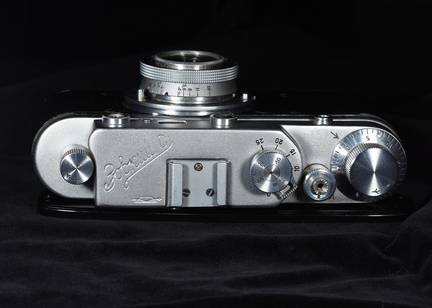

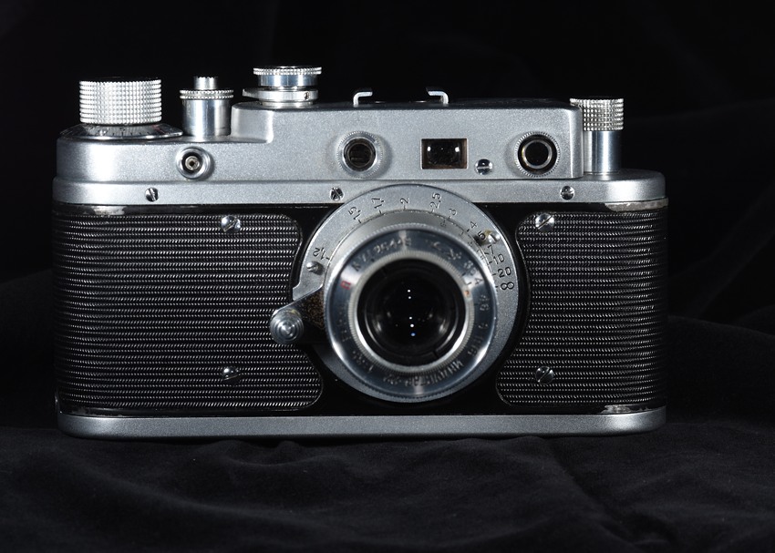

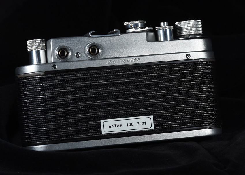

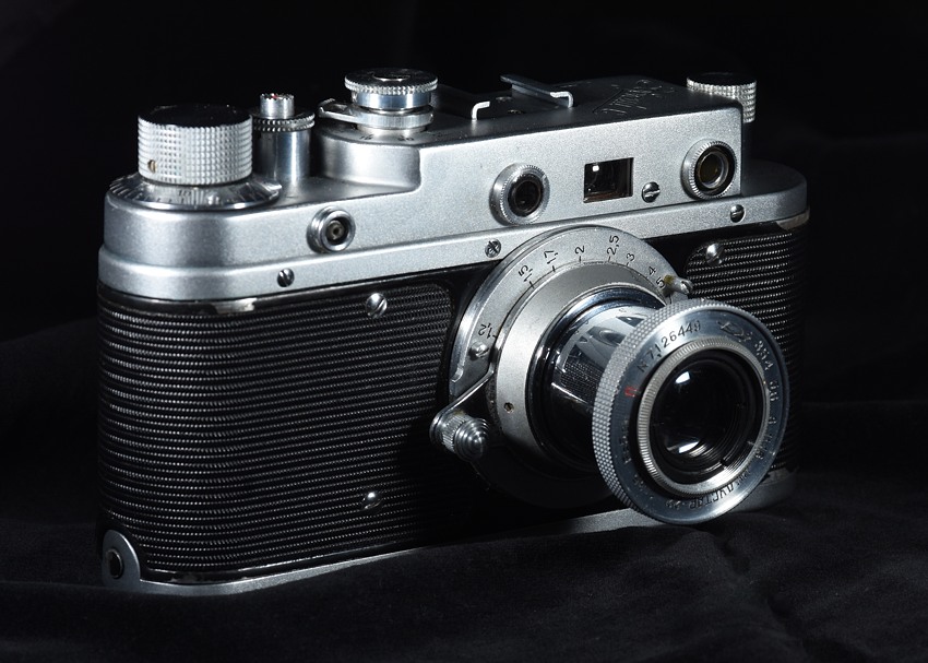

Another to consider which momus said correctly can be a real gamble is the Zorki. I purchased one a while back that said "untested" but it looked good and was quite inexpensive, so I gambled. It has worked flawlessly and at times it is my favorite over my Canons and even the Leica.
It is the Zorki C aka Zorki S aka Zorki 2. Very much like the original Zorki but with flash sync, bulbs and electronic, and the top deck is a bit taller than the original and also the Canons and Leicas. It has no strap lugs and while that may seem a minus I actually like it. The camera has rounded "corners" like the Leica lllF but feels sooo much nicer to hold without the lugs, you would have to hold one to really know what I mean.
5 shutter speeds, 25 to 500 plus B and surprisingly I have never missed any other speeds.
The shutter button is taller and being on the rear part of the deck makes it much more convenient to use than Canon or Leica.
Mine has the Industar 22 collapsible lens which looks like the Leica Elmar but is purportedly a Zeiss Tessar formula. I have found it to be sharp and, since it is coated, has nice contrast.
5 1/4" wide, 3 1/8 tall to top of shutter speed dial (2 5/16" to top of deck) and 1 1/8 thick.
Anyway, if I were to buy another without gambling I would purchase from Yuri at fedka.com
Some pics because...well, why not?
