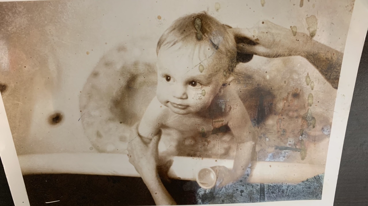

Here it is, if you were curious.
A properly fixed and washed Ilford 5x7 RC print that’s been taped on a cashier desk, in a hairdressing salon, for 12 years.
Yes, according to the Ilford litterature I remember reading, a hairdressing salon is the worst place you can hang a Black and white wet print. The air is just too polluted.
Interesting facts:
- The RC print did start to turn brown and stain very quickly. Within 6 months it was sepia. Within a year, it was in a general bad state. I’d say it decayed 50% within the first year. Afterwards, the decay continued but much slower, until the state in which it is today.
-All other photographs, prints and posters are still intact as they were 12 years ago: I can discern no decay at all, no loss of color, no loss of contrast.
This includes Magazine pages that have been framed, a regular poster, a black and white inkjet pigment print, a laminated poster. A CVS pharmacy 4x6 color print on pearl paper, All look as good as the first day.
I’m kicking myself for not having bothered, 12 years ago, to include a 5x7 RC print which was Selenium toned, and another one Brown toned (reputed for its excellent archival properties). And a FIBER print as well.
The major change occured within the first year. I will make a new experiment involving a well fixed and brown toned 5x7 fiber print which appears to have failed the residual hypo test. I am curious to see how a properly processed and toned fb print, but not very well washed, will stand the test of time and polluted air.
