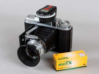

was wondering if these exist?
I was sat wondering the other day, trying to decide between my hi-matic 7s or my zorki 4 and was disappointed not to choose the zorki, which I prefer, my reasoning was thus - in a pinch if I need to meter the minolta has it and I wont have to reach into my bag for the hand-held meter.
and as wondering tends to do, I was led to a place where I figured there must be a simple fix for this problem, to take away the need to choose, a little meter I could fit to my zorki hot shoe and never need to consider this again.
does such a wonderful thing exist?
cds or battery powered?
anything?

The currently manufactured Gossen Digisix has a threaded insert in the bottom and there is an optional shoe mount adapter (which costs about twice what it should) available.

Just get a flash socket, flash adapter or whatever of that kind you can grab at a fleamarket ar alike, and mount the socket proper by screwing or glueing to that Digisix.

The Sekonic L-208 Twinmate used to be sold with a hot shoe adaptor that could be attached to the meter. Its a decent little meter that is relatively inexpensive.

it still comes with the optional shoe. I got one for Christmas and the shoe was included. Still, I think it is more practical to have it in a shirt pocket.
