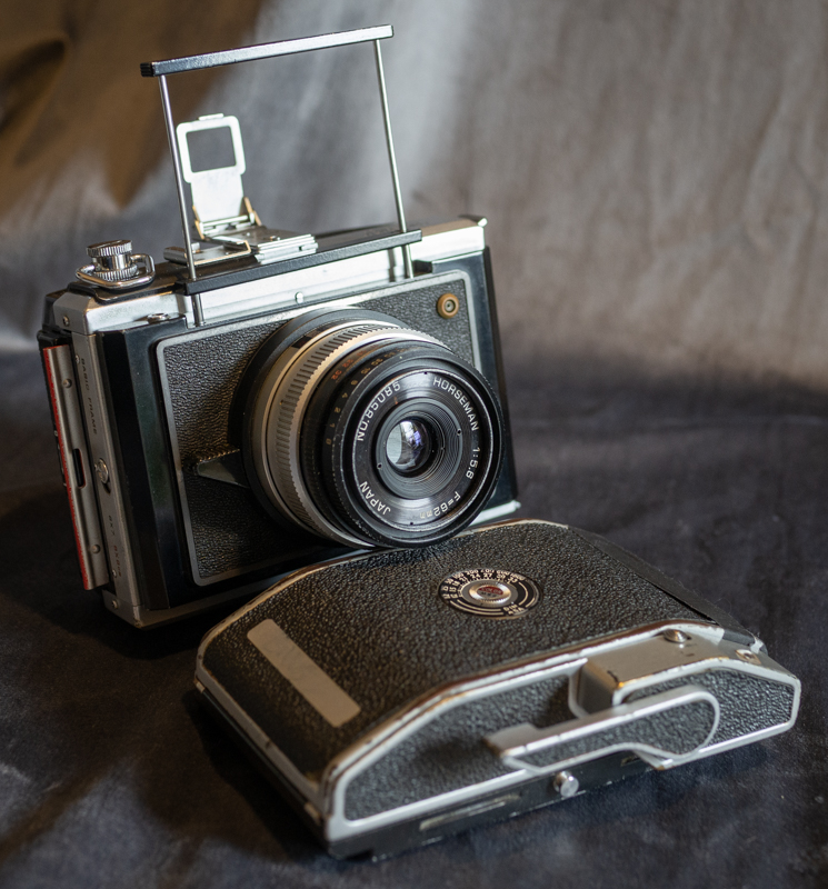

I bought this a few months ago, and have decided it's not for me. IQ is great, but I don't get much joy out of actually using the thing.
For those who don't know, this is a modular, zone-focus, finderless camera that accepts both 6x7 and 6x9 backs. It has a very nice 62.5mm f/5.6 lens and a half-built-in (the eyepiece is shoe-mounted) sportsfinder.

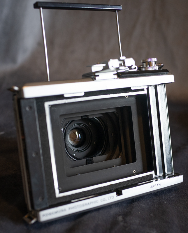

This particular one is in fine shape, with a couple of dings here and there. I replaced the light seal foam where the body meets the back, which you can sorta see in my terrible shot below. Shutter works well and accurately, and the glass is good. I don't have any means of testing the flash sync, so no promises on that.

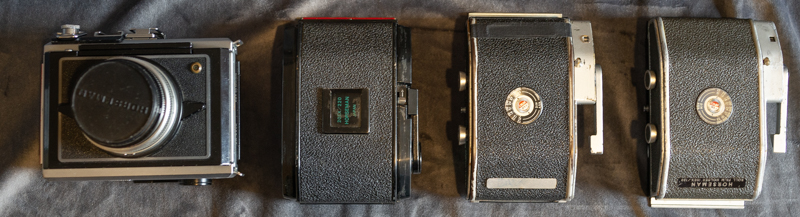

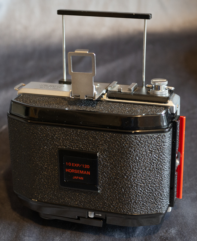

The backs are all functional but at varying condition levels. All have their dark slides, and none have light leaks but could probably all use new seals. The two older backs are single-stroke and designed to have the winder at the bottom. The newer ones are nicer, lighter, and 2-stroke, and while you can mount the magazine with the winder down, that'll put the film counter on the bottom as well. All are 6x7.
1. Older 120 back, probably in the iffiest shape. One of the latches on the door has worn down a bit, so I had to do a little bending and add some overcompensating light seals. It no longer leaks, BUT you can pull the door open with enough force. I'd use this one last.
2. Older 120 back, in ok shape apart from peeling leatherette that I taped down.
3. Newer 220 back, ok shape. Works fine with 120.
4. Newer 120 back, ok shape.
