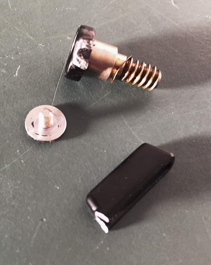

Hey Lumi,
Did you solve this? I have the exact same problem here.

Please forgive me if I have not taken my own apart to check, but it looks like the lever and the shoulder bolt are two pieces. In that case there would a number of options to create a new lever, from casting, or 3d printing or even fashioning one from brass.
I actually made new graflok levers for my Horseman FA when I stupidly tried to bend one of them back after an unfortunate incident in the woods. The lever broke in two but I made a new one from aluminum by hand (and the help of a Dremel):

Hey Lumi,
Hi
I did not solve it. I suggest you contact B.S. Kumar, he may have spare parts. Or fInd a cheap VN for spare parts. I ended up selling the camera, the focus was quite tight so it could be worked.
